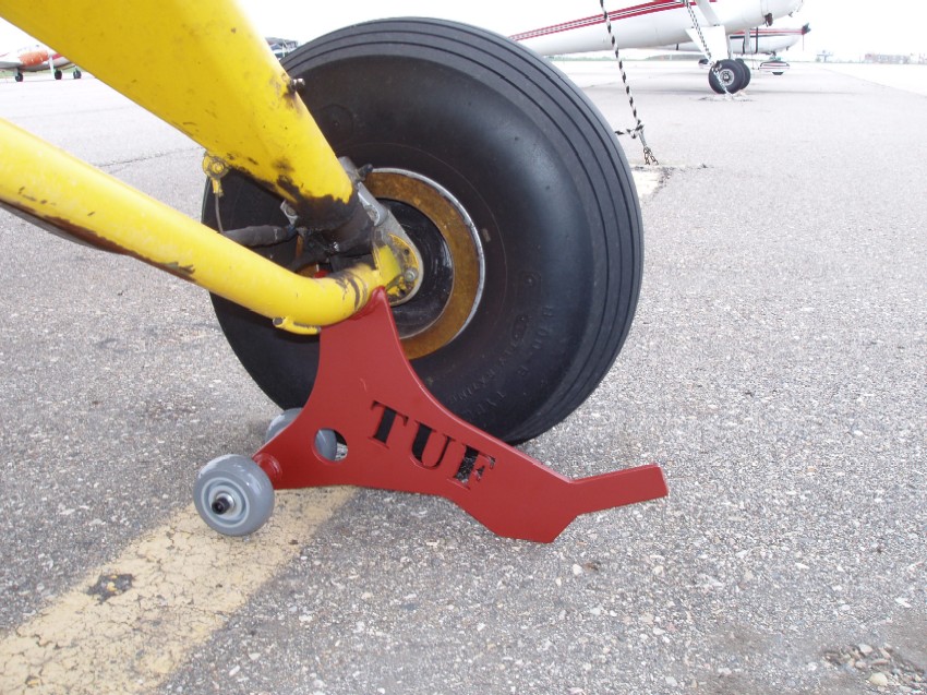

            Hey Tribe!
            Thanks to Bob Waldron (for pics & idea) and all of you guys for the inspiration on this one - here's a pic of what I've come up w/ for Cubs, Champs, Luscombes, etc - no idea if it will work for TCrafts as of yet as I couldn't find one on the field when I went up yesterday to verify (my suspicion is I may have to modify for different height tires / and for TCraft as shown in Bob's pics w/ V shaped pin mount) - hope this helps someone -
            Again - thanks for the inspiration and nod to build these - as you mentioned, I used the original idea and made one - now on eBay.

              Re: Jack for Tcraft
              Darren,
              Nice Jack. I like the triangular plate. If I made another one with tubes, I would add a triangular 'gusset', but your plate idea looks stronger. Looks like your rollerblade wheels are just a little further apart than mine are -- thats good, cause I think it provides a lot more lateral stability. Squared off skateboard wheels probably get another 1/2 to 3/4 inch spread.
              I will be interested to find out how 'universal' it is. Did you have trouble with the wheels touching any of the airplane's tires?
              My friend's has a section of steel tube welded across the top, that fits under the axel. I think he uses a piece of inner tube to protect the paint.
              I couldn't find it on eBay. Hope that it sells well. Good luck.

                Re: Jack for Tcraft
                Thanks Bob!
                Search "Gear Jack" and it should / may come up - in aircraft parts / accessories
                They are actually a caster wheel w/o the caster, urethane rubber on them w/ roller bearings - one of the comments from the A&P's - "nice wheels" =P
                I adjusted them a bit on the second prototype from the first - lifted an 8.00x6 on that Champ (loads of room - loads of oil on it for slipping from the strut, Cub works well w/ 8.00x4's but have to watch original brakes bleeder screws - clevelands on them would work great, Luscombe fit really nice even with wheel pants.
                The tires never hit really as I allowed plenty of room from axle to tire centers - lifts up plenty high w/ most so far and can go higher - actually tucks under the wheel on that luscombe w/ 6.00x6 as it cams over to lock in position - to allow for taller tires I think I should be able to just add more "foot" as I have plenty of Cam Over Center action.
                The first try on the Cub w/ 8.00x4's needed a bit more height on the foot of the jack - which is fixed for second generation! :dance:
                Attached a pic of that Champ w/ 8.00x6's - handle removed for those who wanna tackle building one too!

                          Re: Jack for Tcraft
                          Bill (all of you),
                          Interesting stuff - let me tell you - the response on this has been pretty overwhelming, lots of questions, lookers, interest, etc.
                          When I get more time this evening - I'll post another few thoughts - pros / cons of refininement vs manufacture speed.
                          Love all of the ideas! More late this evening -
                          Darren

                            OKay - full belly - coffee cup in hand.. here goes.
                            Here's the thoughts behind my jack - simple really, especially when I had Bob W's pics to design from.
                            Great Idea!
                            First step to anything! Great to see it in operation through stages of pics - my hat's still off to Bob Waldron (and a free jack if you want one - w/ similar mount to yours - I'll build it special and make it work)!
                            Fabrication speed
                            I wanted a faster way (by utilizing the CNC) to fabricate the jacks - in order to keep my costs down so I can sell them to the masses (faster to put a bit more iron in - and fabricate the way I have than to fit up tubes and weld them all - both end up strong but fitting tubes is less economical)
                            Fabrication Design
                            I have a CNC Plasma Table (amongst my other tools in the shop) that I'm always looking to put to work - design around this where possible
                            Shipping
                            I needed to have them shippable (why don't you all live in my town?) =P
                            Universal Use
                            I need to have them fairly universal in design so the basic design will work from one to the next - ie tcraft, cub, luscombe, etc with simple modifications to mounts, etc
                            Cam Over Action
                            I have a lot of cam over action - ie once it raises to maximum height - it drops down a fair amount too for stability - with this jack compared to Bob W's - the rear tab isn't really needed - I do have more concern for lateral stability - prob should say here that intended use is on hangar floors or nice flat asphalt on calm days - care should be taken while on jack and should be utilized with axle stands for added stability
                            Lateral stability
                            I could see in the pics that at the height Bob W's is that it sure wanted more lateral stability - I designed it to be wider (width can be a tradeoff tho) for more stability - hopefully not too wide that it will hit tires on most - also, because of the amount of Cam Over Action - the small tires actually can go nearly underneath (at least the bulge) of the aircraft tires and have adequate clearance
                            Refinements
                            Adjustability to height, this is a tradeoff to simplicity altho I like the idea of the pivot bolt with a height bolt on an arc to same to adjust. (KISS) Simplicity and ease of manufacture keep bringing me back to 2 different models - 2 different heights (maybe 3)
                            I've also kicked around having a pivoting axle saddle - altho this may be more design probs around stability
                            Price
                            That's the magic question when we get down to it - great original idea, hopefully some good modifications to make it faster to produce! I may be off-base but here are my thoughts -
                            The more universal it is, more mods / refinements it has raises the price - simple economics - more time, more parts = higher cost
                            The little guys (you and I, and most of us) do not want to spend more than we have / can justify on the tool - if it gets too high, we'll figure a way to build our own - even if it takes longer (like Bob W explained - we'll figure a way to make one)!
                            Some of us will want one right away if money is no object and we like the looks / idea / product!
                            Most of us will not need or want a universal jack as we only have 1 plane - and we don't want to pay extra for the universal fit -
                            FBO's operating and doing annuals will actually still need more than 1 unit as they'll be working (in most likelyhood) on more than one plane at a time, thus utilizing the correct height jack for the correct plane, etc and having multiple units will be no problem - financially speaking (I hope)
                            That all being said - and I've probably over-analyzed it - I do like the idea of a down and dirty quick one - for possible field use - altho I suspect not a highly used item as I would suspect if a tire goes down unless a simple puncture - the rest of the plane may need more attention. Maybe for the folks that have never made that big trip to Alaska - and are planning to... probably sell them all kinds of nifty items! =P but that's not what I like to do.
                            Anyhoo - there it is folks... my thoughts on it... now MY magical question.... How many of these, and what price would be fair to you all - the list users???? More quantity / group purchase helps me design around an adequate mount / price for everyone? (eBay does work quite well for the seller / buyer - market adjusts itself pretty much - basic idea of supply and demand)
                            Hope this helps - long post for a simple item.... let me know - off-list if you'd prefer - what one is worth and I'll do my best to provide a cost effective gear jack for everyone - here's my info -
