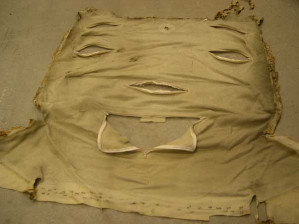

    I got a very old, ratty headliner with my project. It appears to have fit the plane at one time and I'm going to use it as a pattern to make a new one. But, of course, many questions have come up in the process of planning this part of the project. Any Taylorcrafters with information (or opinions even), please chime in, I could use your input.
    The old headliner is made of a tan colored wool material. The local fabric store has an apparently identical wool material for $16 a yard. So my first question: is there anything special about the wool headliner material sold by Spruce and Airtex and others...or can I simply buy local?
    The old headliner has a total of 6 zippered openings, I would like to simplify: (Opening 1) a large, aft "T" shaped opening made of 3 zippers. This opening allows access to the aileron turnbuckles. (Opening 2) A mystery opening in the center of the headliner, 9 inches long, roughly above the center of the seat. Question Two: this mystery opening appears to have no function, can I safely eliminate it? (Openings 3 and 4) Right and Left sides. These openings appear to allow access to the fuel tank valves. Question Three: I only have a wing tank on the right side...do I need a zipper opening on the left? or if I move the tank valve to under-the-panel do I need any openings at all? and (Opening 5 and 6) right and left front cornors of the headliner, inspection holes for the aileron pulleys in those locations. Question Four: do all headliners have these openings? If the headliner is attached to the right and left "V" tubes, then the pulleys are accessable from the windshield side, and a zipper is not needed?
    The old headliner was suspended by 3 (3?) hoops made of 1/4" ID copper tube. The copper tube was enclosed in pockets and then safety wired to the wood stringers above the cabin area. Questions Five and Six: copper tube hoops, is that the right stuff? what are others using? and how are your hoops attached? are they just hanging there?
    And finally, the old headliner seems to have been attached to the airplane with staples and glue (contact cement?) What is the correct adhesive? Are stapes supposed to be used in addition to glue?

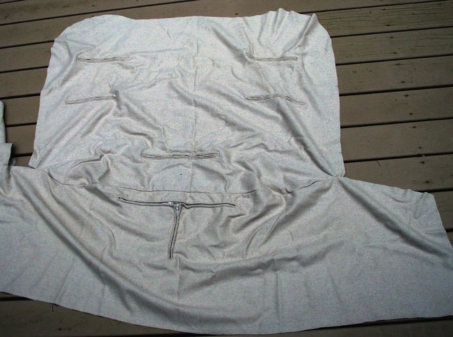

    I took the (ratty, hanging down) headliner out of N43457 many years ago and bought a new headliner from Airtex. I still have it....so I shot a pic real quick for you. It looks pretty much the same to me. Hope that helps a little!

        Yes, thanks Vincent, that does help.
        So that's what they're supposed to look like. I like that gray color. I'd thought the yellowish color of my old headliner was normal, but it may just be the effects of age, dirt, and too much sunlight exposure. (My face looks that color some mornings in the mirror)
        Any idea what that center zipper is for?
