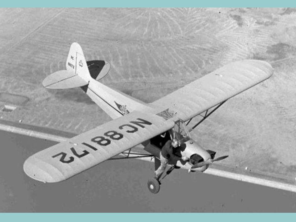

              I forgot where I found this picture, but I thought it might fit in on this discussion. I'm not sure I would want to be the one doing the hand propping.

                If memory serves, I remember reading an official looking story that the guy was actually changing spark plugs......perhaps during an endurance record?

                    The picture of the fella changing spark plugs, stopping his prop, looking for mice... or whatever he's doing at 3000ft., and without a parachute gives me the willies. There's crazy and then there's Britney Spears Crazy... I think that qualifies as both. With regards;
