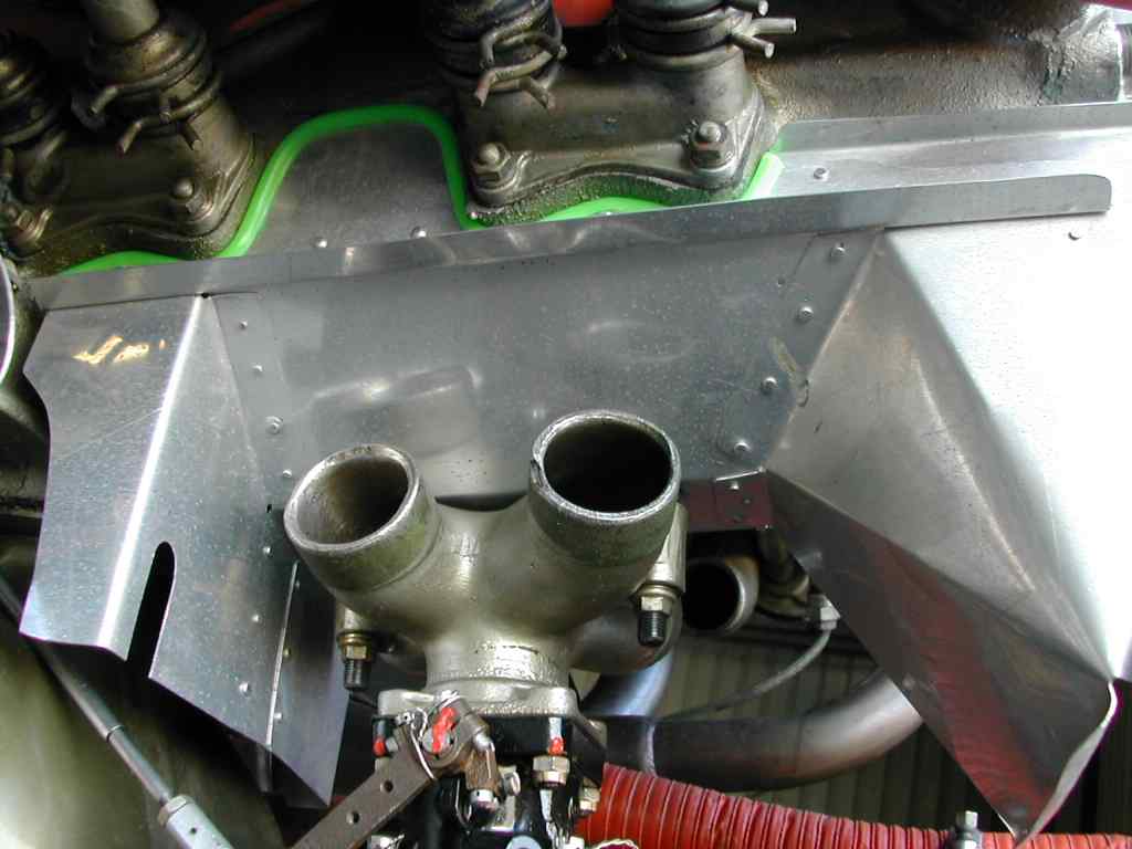

      Re: Cooling Baffle Project

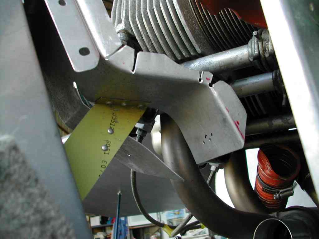

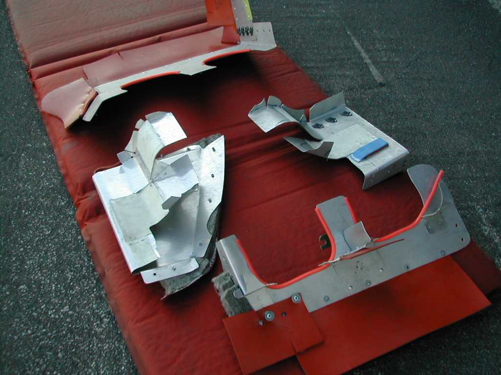

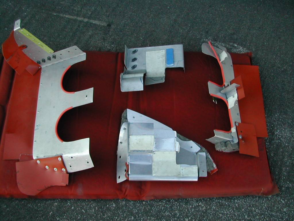

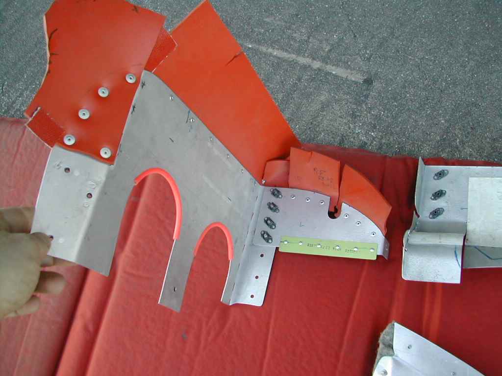

      Cyl. Baffles Photos Group 1
      Bright red and green stuff is small dia. hi-temp silicone tubing, split and slipped over the edges of the metal as a bumper/gasket.
      NOTE these photos were taken BEFORE final installation of the baffles, so NOT ALL parts are shown in these photos. The inter-cylinder baffles are not installed in these photos, nor are the lower hold-down plates and safety wire tie-downs.
      AN470 AD 3 aircraft rivets were used on the joints except where the rubber material is held on with pop rivet "baffle rivets" which are standard for this function. The "baffle rivets" allow easier replacement of the rubber seals than AN rivets would.

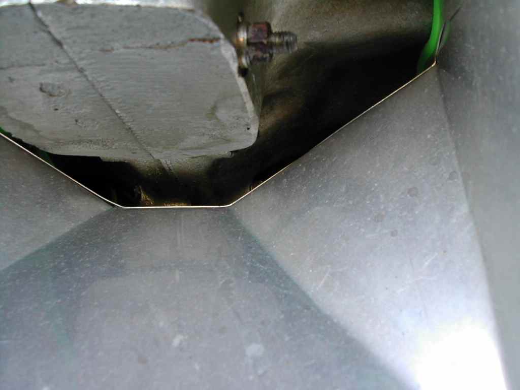

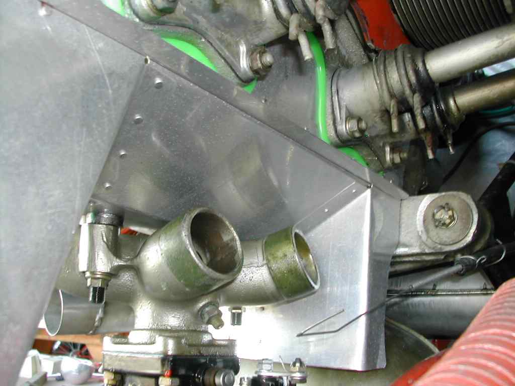

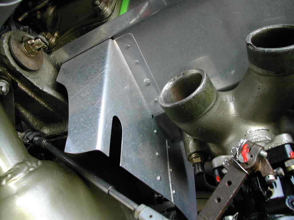

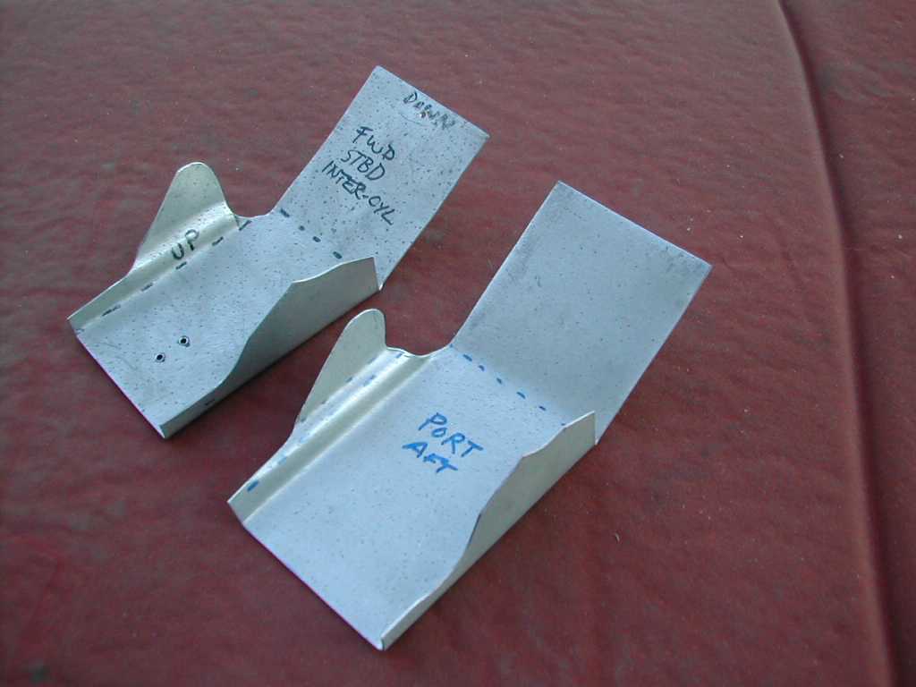

        Cyl. Baffles Photos Group 2
        Note 4th photo shows alum. spacers necessary to allow clearance between the intake spider hoses (not shown) and the baffle.

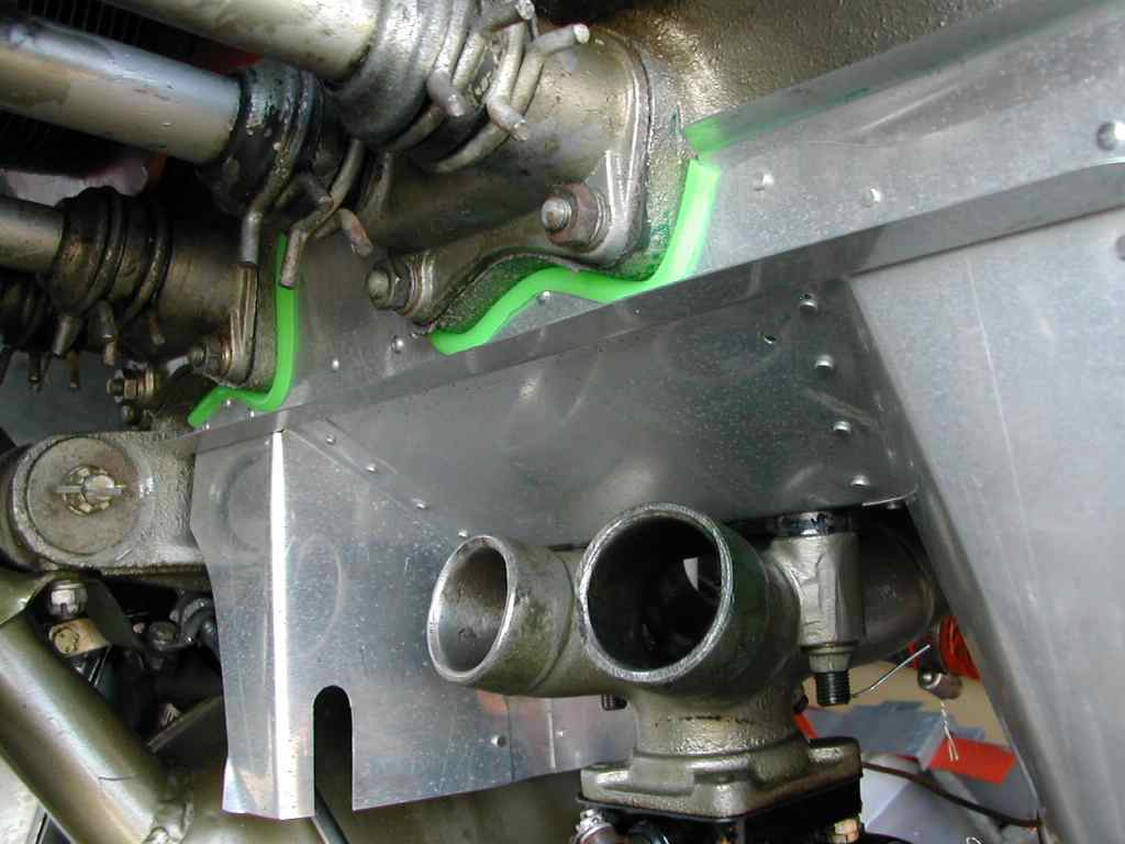

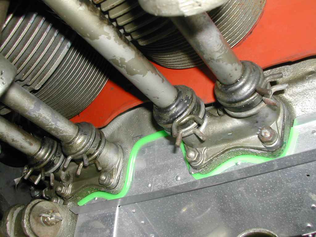

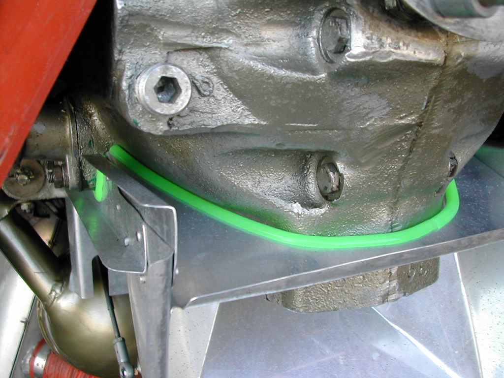

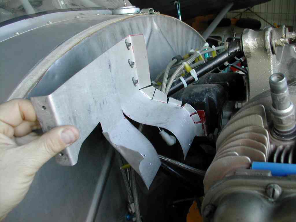

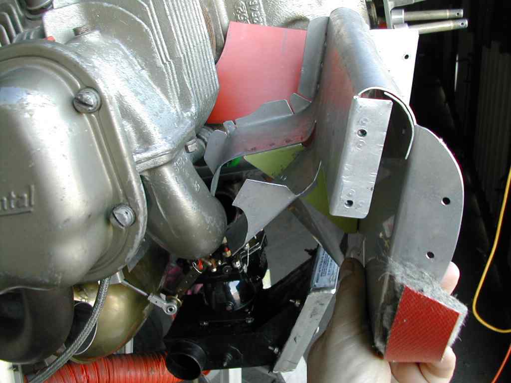

          Cyl. Baffle Photos Group 3
          Red silicone 400 degree rubber (standard aircraft baffle seal material) forms the inboard wall of the cooling air exit duct at base of cylinders for smooth outflow into the lower cowl. Note 3rd photo that the baffling only touches the inboard (lower steel) portion of the cylinder cooling fins at one point, does not "hug" the contour of the cylinder. I believe this is to prevent the bottom of the cylinder from over-cooling where it does not need as much heat rejection as the cylinder head. Note 4th photo silicone hi-temp baffle material forming to the contour of the cyl. head to keep all the air flowing through the fins around a large part of the distance from top to bottom.

            It sure looks purty. I like that green stuff, looks like the green hornet was there.

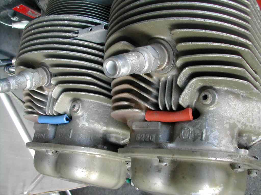

            In the last photo you posted there are what looks like pieces of silicone rubber in the space in the top of the heads. What is that for. I thought those holes needed to be open for better cooling.
              Those holes only need to be open to let the air flow between the cooling fins inside the hole. But the fins only take up half of that hole, the other half is wasted flow. So covering the wasted part makes it so that the useful part (the fins) get almost twice as much air. What I did was not to cover the fins anywhwere (of course), but to cover everywhere other than the fins.

                  hey bill are u going to make up some drawings so we could use that design id like to try it with my c-85
                    I mostly used O material on the parts I had to compound bend. There is some T-3 that I started using for straight bends because my hangar neighbor lets me use his brake
                    If I had it to do over again I'd probably put less compound bends in, and make the bent flanges smaller... I got too carried away with this set. The only place where there really needs to be a compound bend is at the root (small) end of the cylinder where the cylinder baffles meet the inboard wall. Even this is not absolutely needed.
                    Also, if I could do it all over I could make it with far less parts count, some pieces could be riveted together and not have to come apart.
                    i did make SOME tracings but they are not accurate. I had made paper patterns (usually two or more times) and then all the parts had to be hand-fitted anyway. So my patterns would not do much good unfortunately.
