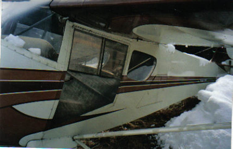

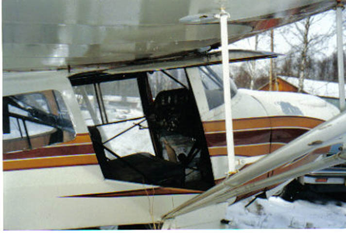

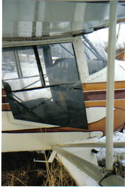

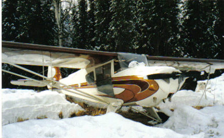

Here's one on a BC12D... If I remember, this one was sitting in Wasilla, AK.
JHI'm so far behind, I think I'm ahead
Re: custom doors ??
I know that plane. It is in wasilla it belongs to charly center.
There is alot of doors like that here in alaska.Lance Wasilla AK
Re: custom doors ??
Yup thats the guy.Lance Wasilla AK
Re: custom doors ??
There ya go..thanks... jolted my brain into gear!Originally posted by matsuthunder200 View PostI know that plane. It is in wasilla it belongs to charly center.
Tim, you'll have to try for a field approval and build them yourself... not that big of a deal...just make sure you get the approval BEFORE you start cutting your doors.
