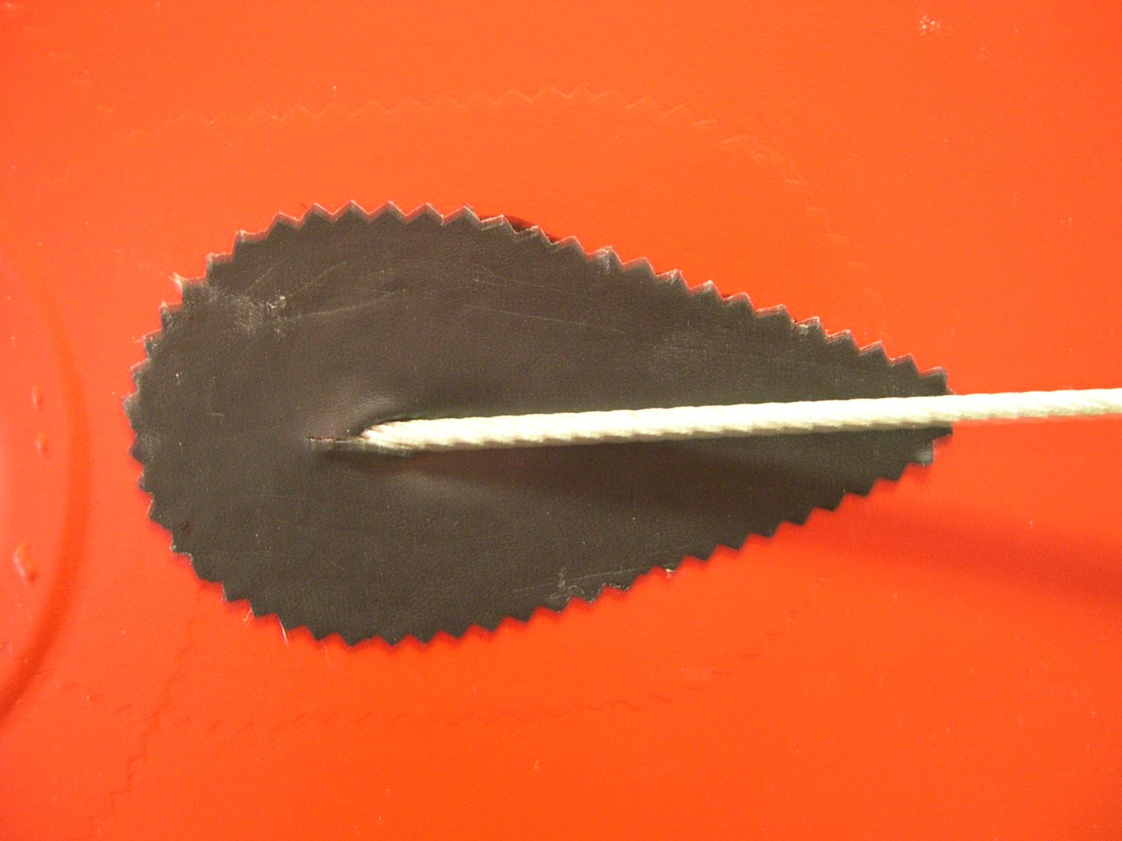

      The A-729 patch looks a bit crude to my eye. I modified it as follows: I kept the 4 1/2 length, but used a 1 1/4" radius in front and a 1/4" radius aft (instead of tapering to a point) And the top and bottom lines are not straight, they are slightly convex...about .3" camber on each line.
      I got some soft "glove" leather from HobbyLobby and cut out the patches with my pinking shears. There's a 5/8" long cable slot that I cut with a Xacto knife. 5/8' is just long enough to allow pushing the cable end fittings through while still giving a pretty good seal around the cable.
      I glued my patches on with Poly-Tak.

        Looks a LOT better than what was on my plane (big ugly race track ovals). I would suggest making a small round hole at the ends of the cable slot to keep the leather from tearing.
        Now I need to find some nice maroon leather and take those nasty patches off my plane.
