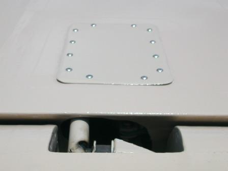

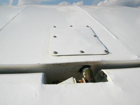

The rectangular aileron bellcrank inspection panels on the top of my wings run side to side, but most others I've seen run fore and aft, like the photos below. Does anyone know which orientation is correct? And how many attachment screw holes did those panels originally have? I think I remember seeing a factory drawing with eight screw holes...

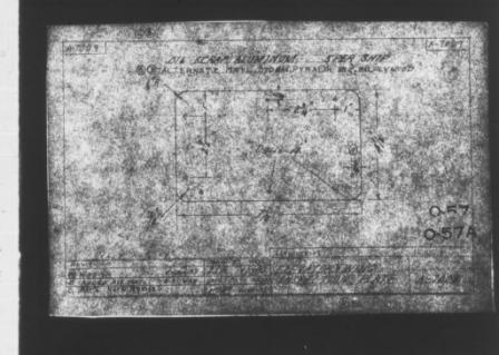

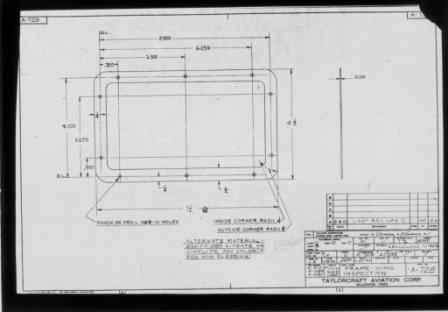

OK, found the drawings of the 4 1/2 inch x 7 1/2 inch inspection panel and its frame. Looks like eight screws.
"Side to side": Now I'm confused. On my plane, the 7 1/2 inch long side of the panels run parallel to the trailing edge of the wing, perpendicular to the ribs. Forrest, do I understand you to mean that the long side of the panel should instead run parallel to the ribs, as in the wing photos above?Joel Severinghaus

Just realized I compressed those jpg thumbnails of the part drawings so far they're barely legible. PM me with an "outside the Forum" email address if you'd like me to email you the original, bigger, and readable files. The original files were 726 KB and 1.45 MB.Joel Severinghaus
