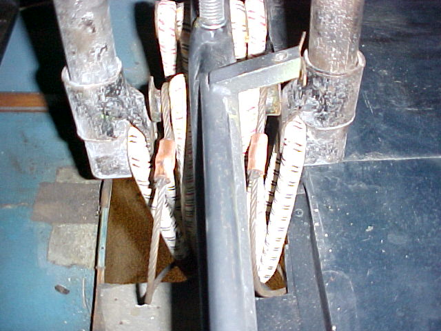

    swapped the bungees today. it was INCREDIBLY EASY with Dave's tool! The tool is extremely well designed for the task. Took us longer to remove the bungee covers and seat than it did to actually put on the bungees.
    The old bungees were in fact 9010HD's despite it being a Jan/1946 BC12D so I was glad that I ordered the correct ones. The plane now sits level whereas it used to sit left wing low and also the safety cables had really dug into the old bungees. It's all back together the proper way now and a few test flights around the patch and all is well.
    Is this something I can make a logbook entry in myself? or does an A&P have to look it over and make the entry?
    DJ,
    Replacing elastic shock absorbers on landing gear is specifically listed as a preventive maintenance item in FAR 43 Appendix A paragraph c(2).
    If you look at FAR 43.3(g) you will see that a pilot is authorized do preventive maintenance on an aircraft he owns or operates (unless you operate under part 121, 127, 129,135).
    So you can do this all yourself but you need to make a log entry per FAR 43.9
    I recall the instructions that come with the tool tell you to make a log entry but don't explain all the legaleeze of why it's appropriate for you to do that.
    Perhaps I should add that. What do you think?

      It probably would have been better to have your A&P sign it of BEFORE you took it around the patch to check it out...
      yeah but I recall seeing somewhere it being written that the shock cords were preventative maintenance items that can be done by the owner holding a PPL... but my memory had faded.
      it's really not a complicated process. less complicated and less things to go wrong than say changing brakes or the like.
      Albeit, I agree to be completely legal I should have made an entry before the test flight.

                              DJ,
                              Sitting around a hotel in Baltimore, bored out of my mind, I had nothing better do than peruse the FAA website for the regs on owner maintenance. Obviously if a mechanic (familiar with Taylorcraft) is around, it would make sense to tap that knowledge and experience.
                              Pasted below is three sections. The first, paragraph g, states that we as owners can do "preventive maintenance". The second part is Appendix A which specifically lists what constitutes "preventive maintenance". Check out item number 2. And the third part tells you what to put in the logbook. As you can see you just make reference to the maintenance manual or AC43.13, which is the approved methods and practices. For the sake of brevity I edited out some of the legal lingo in the first part. It is still pretty long, but I thought you or others might want to see the entire list of items.

                                That is the gospel and sure you can do the shock cords IF they are done correctly and properly signed off in the aircraft maintenance records. Who can do "work" on an Experimental Aircraft Anybody!!
                                The final responsibility is with the A&P or Repairman who does the "conditon inspection"
                                Who may work on a certified airplane? anybody if they comply with the applicable FAR , supervision, preventative maintenance, etc.... The problems I have seen are people working on these ships that do not know what they are doing.
                                I just adjusted the idle air on a Stromberg after the owner and his buddy had been screwing it the wrong way to "lean" the mixture. A bit nippy out there in the field here in Ohio!
