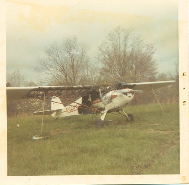

            DJ,USE ROPES!!!!!!!!!! Here is what a chain on the tail tie down done to our family T-craft.She has been in the family since the 1950's.She taught my father and grandfather to fly.On May 6,1971 she was setting on her tiedown and was hit by lightning during a thunderstorm:doh: .It was said that the chain on the tail tiedown grounded it and turned it into a lightning rod. Now named Crispy Critter I hope to test fly her on or before Thanksgiving weekend:dance: :joy: :tup: . Use the ropes.
