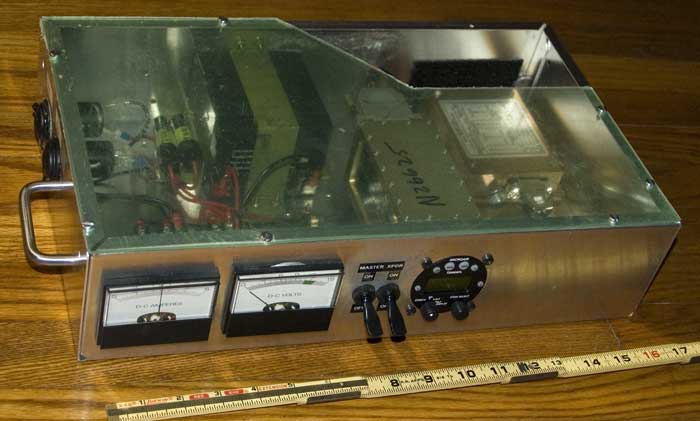

      After some months of frustration, I flew to Lancaster, PA (LNS) yesterday where the helpful folks at Lancaster Avionics got an OK from the Harrisburg FSDO to test my portable box for a bi-annual transponder check and enter it in my log. Simple and quick. A photo of the box is attached. It straps in front of the seat, and runs the transponder and encoder for 7 hours on a 5 amp-hour radio shack sealed gel cell battery. Charging is through the cigeratte lighter socket on the side. The antenna is mounted under the fusalage and easily plugs in to the transponder. The whole unit weighs about 7 pounds.

          I put the box together using an Aluminum chassis from www.newark.com, standard analog volt and ammeters, switches, fuse holders and closed gel cell battery from Radio Shack, a Microair transponder and Trans-Cal encoder from Aircraft Spruce.
          The combination draws about .4 amps, which runs 7 hours on a charge -- the encoder stops working when the battery voltage drops to 10.5.
          There was no field approval needed -- just a logbook entry that the transponder installed meets the requiements of FAR-91-413 and FAR 43 Appendix F.
