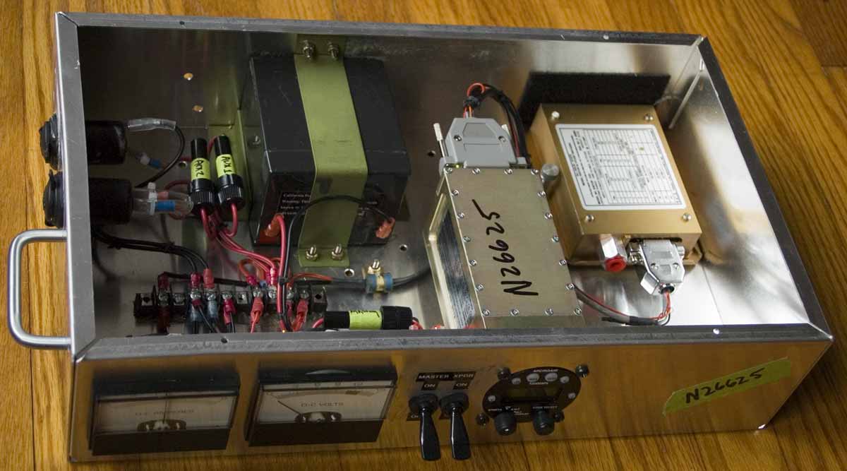

          Progress (or lack of) report. Well, I have an approved antenna mounted under the cockpit, and built a box to hold the battery, transponder, encoder, meters, etc.. (picture attached). It all checks out fine, straps between my legs ahead of the seat, and runs the transponder/encoder for 7.5 hours on a 5 amp/hr. However, I found out that my local shop is aftaid to sign it off as it contains non-approved components (battery and meters). I've found that the local GADO is refusing to even consider any such approvals. I'm looking for a avionics tech outside of this area who has a more responsive FSDO to work with. Any thoughts?
          I'd be willing to take the box apart and permanantly mount the transponder in the panel, encoder on the firewall if there were an approved small battery that could be removed for charging (or even go with a small approved wind alternator like the BPE-14 Turbo Alternator.
          The rub seems to be the battery -- there is apparently no approved aircraft battery less than 25 amp/hr. An overkill and un-necessary weight penalty for
          an early t-craft. I wonder if the foundation or some group of us could work with a battery manufacturer to get a STC for a 5 to 10 amp/hr gel cell approved for t-craft. I suspect that once done, it would not take much to approve it for Champs, Chiefs, Luscombs, etc. and have a good market with no competition.

              Thanks for the comment. There seems to be a bunch of catch 22s. As I understand it, the transponder/encoder must have a bi-annual signoff to be legal in controlled airspace. My avionics shop reading of the regs says a transponder must be permanantly mounted in a particular aircraft, so they won't signoff the bi-annual unless I get an FAA approved installation via 337, field approval or whatever. If it is permanantly mounted, there is apparantly no way to power it in a no electrical system aircraft.
              For any of this the local GADO is not accepting any such applications. See Bill Berle's thread
              !)$(^@ FAA SOB's Trying to Shut My 337 down!
              for similar frustrations.
              So, proceeding in 2 directions now -- trying to find an avionics guy willing to do a bi-annual on a portable box and trying to find a way to get FAA approval for an installation in the aircraft in a different GADO.

                Dan - as you are aware, some folks are simply carrying the xponder around in a box and removing it when they leave. What's the matter with that approach? - Mike

                  Mike,
                  The rub seems to be FAR 91.413 which requires bi-annual tests of the transponder by "A certificated repair station properly equipped...". Any leads anyone?

                            That's a vey nice installation Dan, but like Mike says, why not just keep it portable. A transpnder that hasn't been inspected every two years is better than none, and if you're concerned about the FAA being more responsive on the line than in the office, keep it portable and carry it with you. It could just be an 'oversized intercom' .
