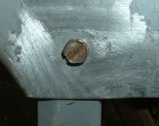

                  Rob - here you go; 5/32" across the flats - Mike

                    I remember those screws all over mine! Pain in the backside to get out. Lots of heads snapped off abd others the screw slot stripped or the flats rounded. I found a really clean (not rounded or loose) small socket worked best. Soak it is penetrating oil or oil of wintergreen followed by silthe twisting gently back and forth with the socket to break it loose. Never broke one or striped it after that. Got to be REALLY patient!

                        If you put valve lap compound on your screw driver it helps stop the blade from slipping out of the slot. george

                              If you can't get a socket on a screw, and the slot is bad, you can use a hacksaw and cut a new slot in the head of the screw, but don't cut the slot too deep or the head will break off. Cut the slot only as deep as the original slot.
                              Also, if a screw head is sloppy in the socket, try using a metric socket. sometimes they will help get a better grip.

                                A 6 point boxed end wrench works much better ,grind about 1/3 of the wrench away so it lays flat on the leading edge and grips much better
