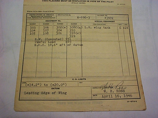

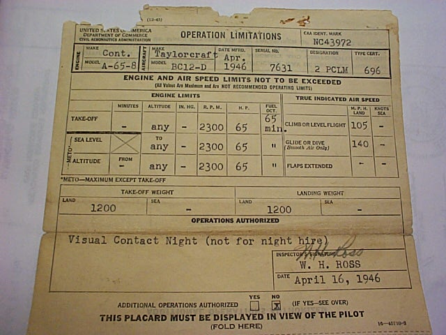

                    Hi Jim,
                    My scanner does not work so I took pics of mine.
                    Dave.

                      Re: POH for BC-12D
                      Bless you, I have been putting out fires last week and now this one too. I was going to scan mine but the scanner took a dump. Got another one today. IF it storms tomorrow, I will do special tools & the Operations Limitations that is a "Required Document" when you go fly.

                          Re: POH for BC-12D
                          I have copies of that form for my airplane from in the past, but do not have a current one. How do I get one and make it official?
                            Re: POH for BC-12D
                            Current? they were issued with the airplane when built, that is recorded with the FAA at Oak city , I get most of them off the CD of the records. THEN any changes are ( wt & balance, etc.) done at the time of any 337 or entered into the aircraft maintenance records ( log books) . THAT little piece of paper is REQUIRED to be in aircraft when operated.
                              Re: POH for BC-12D
                              Which little piece of paper? The Weight and Balance, or the one with the so called operating limitations? I have a weight and balance, but the other one I do not have. Neither of my airplanes have that one.
