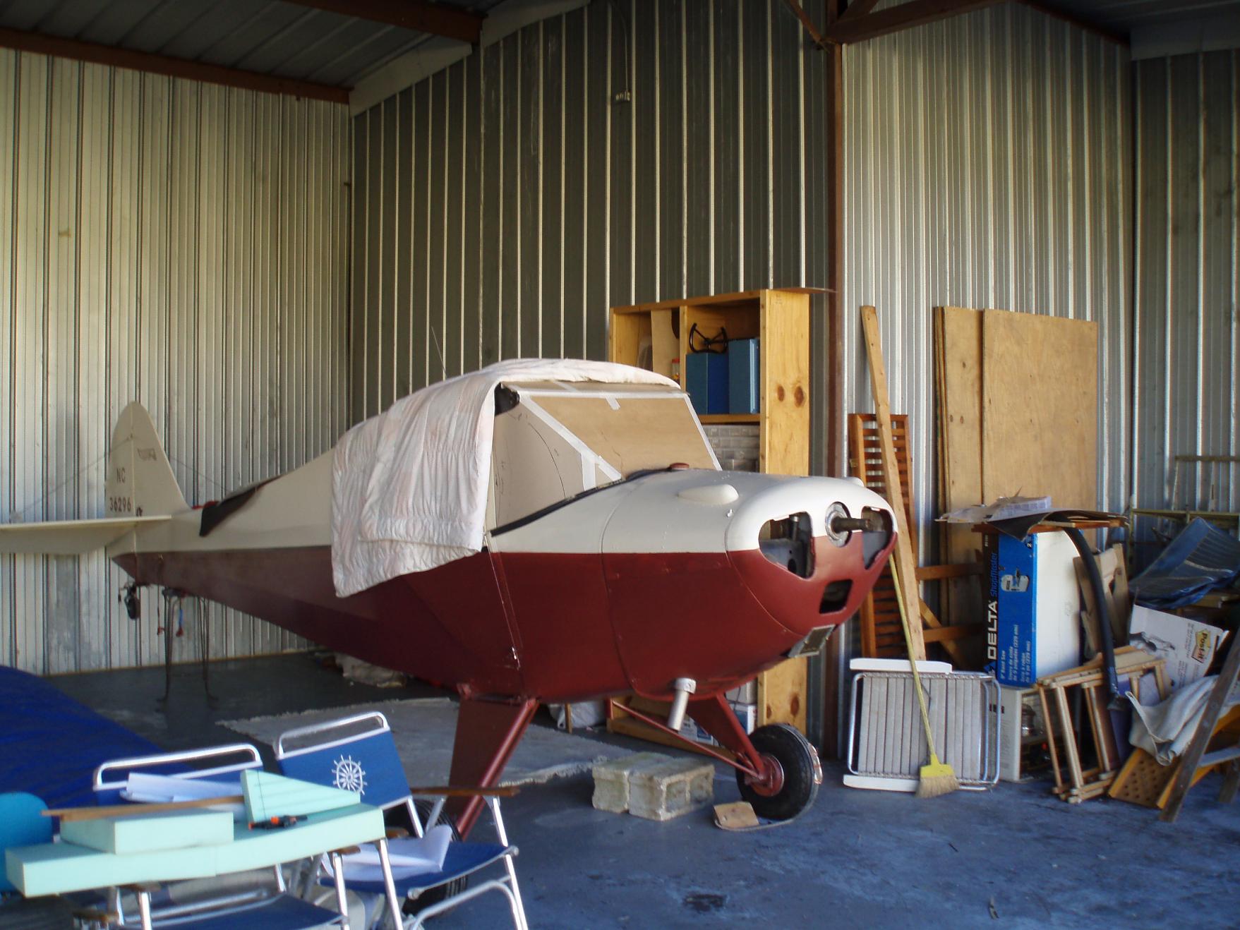

    I just came back from my friends hanger . The traceings we have are onky for the metal partrs NOT the glass. Sorry IF I mis-led everyone. It apeared to me to have the glass but does not. I think all we are going to do is use a one peiece windsheild and put on the metal stris so it looks original. I sill send some Picks of the plane.

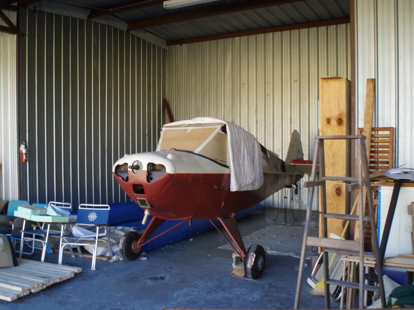

            I'm digging around looking for the people who wanted the engraved Taylorcraft logos for the big compass and came across this thread. Needless to say the 4 piece pre-war glass was harder to get fitted than I thought it would be but I DID get it done. I could have sworn I posted photos of the finished product, but in case I didn't, here is one from last fall. Can't remember if I still owe anyone tracings of the parts but if so, just keep yelling till I respond.
            All who know me know I am slow and let things get lost on the home/hobby front. I am a lot more focused for the manned space program. :rolleyes2:
            With Obama's new NASA budget that may not be a problem pretty soon. They are calling the Constellation program "Canstellation" at Langley Research Center. I may have a LOT more free time pretty soon.
            Anyway, the windshield/windscreens came out really nice (and have survived the wild temprature changes here recently.

                        Looks nice Hank. :tup: Is this a 3 or 4 piece istall? If a 4 where is the 4th? Larry
                        • #57
                          Re: Windshield and Open Cowls
                          It is 4 piece. There is the front windshield, the two side windscreens and the top piece that curves from the top of the windshield to the main spar.
                          I went out yesterday and while I was there wanted to measure the thickness of the new door windows to compare it to the ones from the 45. Anyone know how thick the windscreens and door windows are SUPPOSED to be? Mine are .080 on the 41 and the more I look at it the thinner that looks. I would hate to have to change them out again, but I would hate it more if they failed in flight! Anybody have an original piece they can measure or the drawings?
                          Forrest?
                          I plan to take the whole mess off again to finish putting in the panel parts and mount the trim indicator. That will let me take the windscreens down to a plastics specialist to cut the holes for the vents, so if they are too thin NOW is the time to fix them.
                          Might be a good time to reroute all the engine control and sensor lines through the firewall and maybe even pull the tank too to check for leaks while it is all apart.
