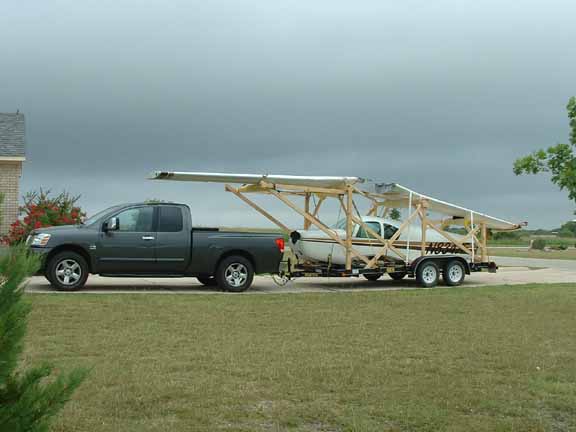

                    Ok, not a TCraft, but you guys might still find this interesting.......
                    My Dad, Brother-In Law and I just drove up to Minneappolis and picked up a Mooney M20A (parts plane). Drove up, stayed overnight and started taking the plane apart and building a jig on the trailer at 8am. 12:30am we finished and started driving home. (Luckily two airport bums were hanging out and lent a hand!!!) Did 55mph at 7gph all the way home. Took 26 hours (back).
                    Am I nuts? After this trip. YES.
                    On a side note, my Truck impressed the heck out of me! Also, transporting a Tcraft would be cake to this!

                      That's quite the rack, Richard!!! Glad ya made it ok... thanks for the story!!
                          Richard Boyer
                          Richard,which cost more..the rack or the mooney????LOL,kidding
