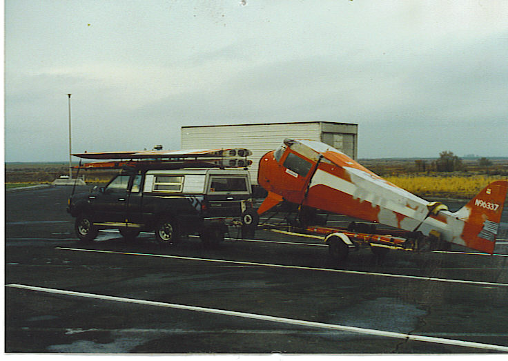

I told Mike how I did mine in an earlier post... I took the wings off and faced them bottom to bottom, then ran short metal tubes, between the strut attach points with the strut attach bolts through them, both front and back, and had two longer metal tubes that went through both wing spar attach points with the attach bolts run through them. This held the wings apart, and rigid, then I put them on top of ski racks that were padded (placing the bar between two ribs) and strapped the front down gently (only tight enough to keep them from moving while underway). The wings were facing with the tips forward. The metal that passed through the spar attach points had a "tee" on the end, and that was attached to the rear of my canopy on my pickup... then I hauled the fueslage behind, facing forward (pulls MUCH easier that way, than facing rearward, and is much more stable!!). It rode just fine this way over 600 miles. See the attached pic.
JHI'm so far behind, I think I'm ahead
