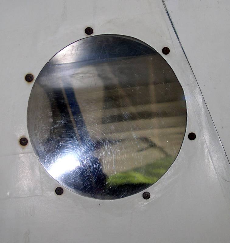

      Re: 1946 BC12-D Rear "D" windows
      There's actually a set of these aluminum frames for sales on Ebay right now! My T has portholes for the back windows....they look nice but don't add a lot of visbility or light.

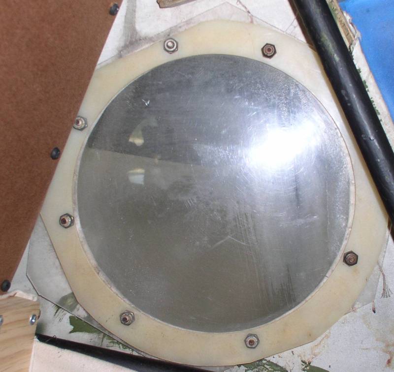

          Bob,
          Here's the ones on my BC12D. It's a pretty simple set-up and I've had a lot of people mention how much they like the round windows, but I still prefer the big back windows. I've got the frames for a set of Stinson back windows and they look just right when I hold them up on the T.
          They still have that vintage look and the shape flows very nicely with the lines of the airplane.
          Vincent
            Yes, Vincent, that's a very cool window. Am I correct that it is an inner and outer aluminum frame with a round plexiglass pane sandwiched between? #8 screws hold the sandwich together? Is it attached somehow to the door frame or the tube below?
            Very nice indeed. I'm thinking that it gives your T-craft a pleasant antiquey look. Do you happen to have a profile photo available of your plane?
