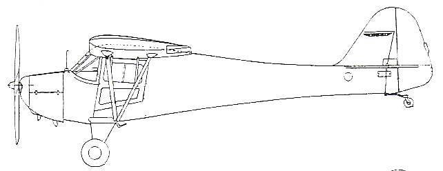

          I really like Bill's coloring book idea. Some time back I saw some drawings of a blank (no color) T-craft (in the Taylorcraft newsletter?) Is there some way to scan those drawings into the "Paint" program on the computer and then use it to experiment with colors? My computer skills are not up to the task, but perhaps some bright fellow can show the way?

            I found a plain drawing of a t-craft for color testing on dedreckon.com(I think that's the site).That's what I used and I colored about 50 of them and this is the one my father seemed to like the best.
              Re: New Crispy Pics in Gallery...
              Here's the one from my Taylorcraft gallery. This is exactly what we made it for......it's actually right out of the newsletter, but we blew it up a little and removed some superfluous lines to make it a little cleaner. Feel free to copy and use it. You CAN export it into Windows Paint.

                  That is the same one I used.

                      Thanks for the blank Taylorcraft drawing. I'm going to use it to experiment with colors. If I come up with anything clever I'll post it here!
