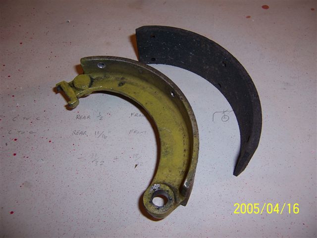

        I have the mechanical Clevelands and relined them as part of my rebuild. Once that was done they hardly fit back in the drum! There is also a metal insert in the shoe assembly where the cam contacts. Perhaps it is worn effectively limiting your travel??
        Grant S. Bailey
        C-FXSU
        1951 Model 19
        Delta, B.C.
