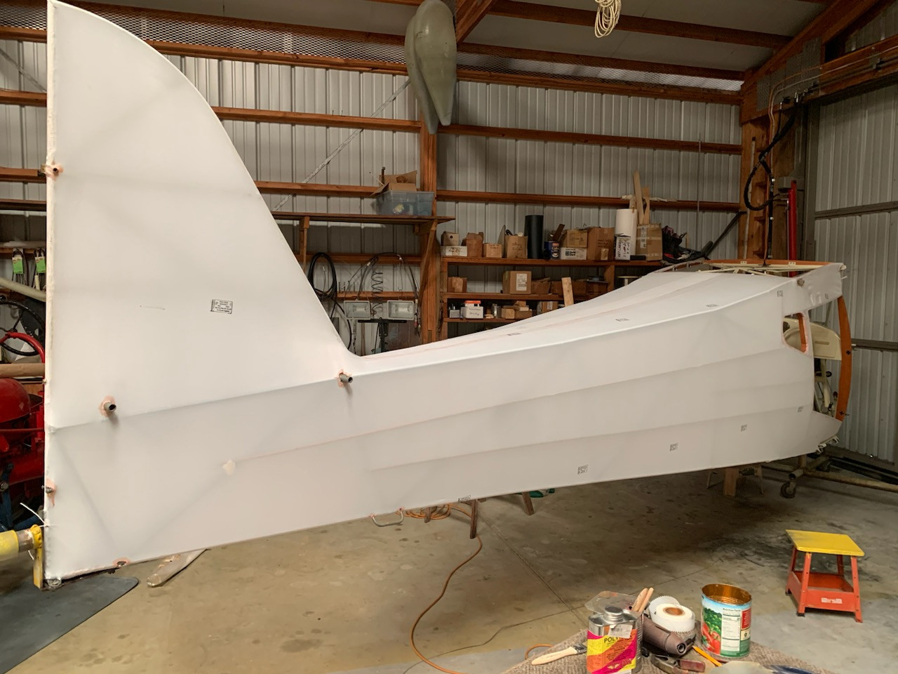

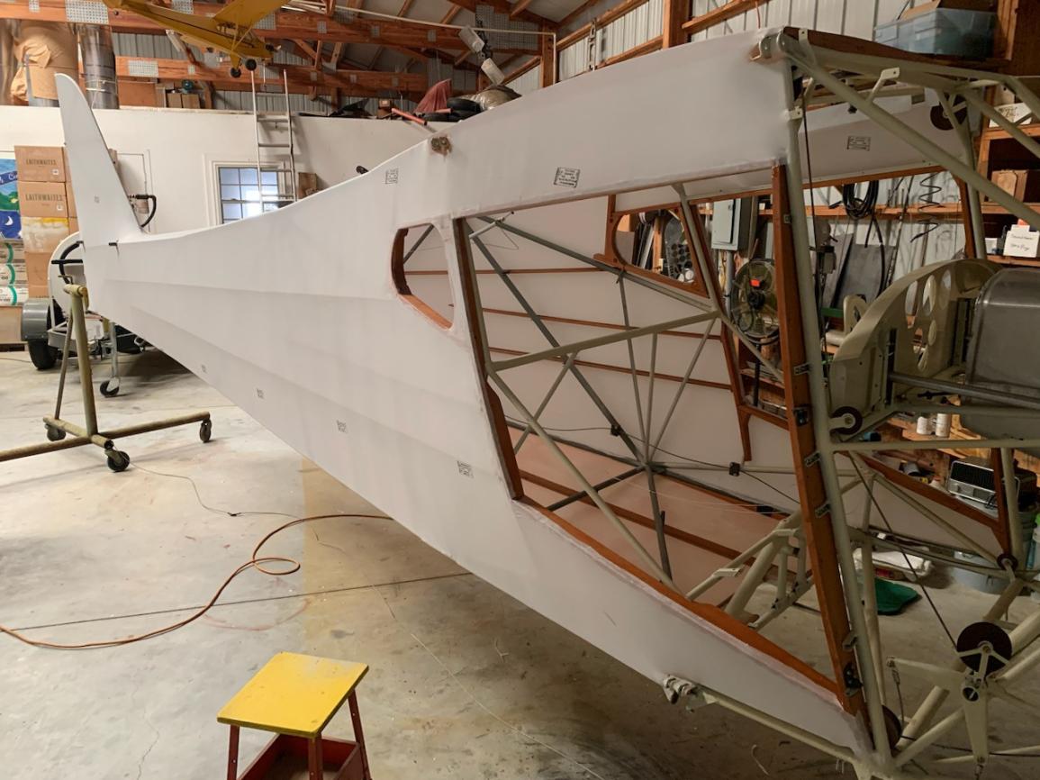

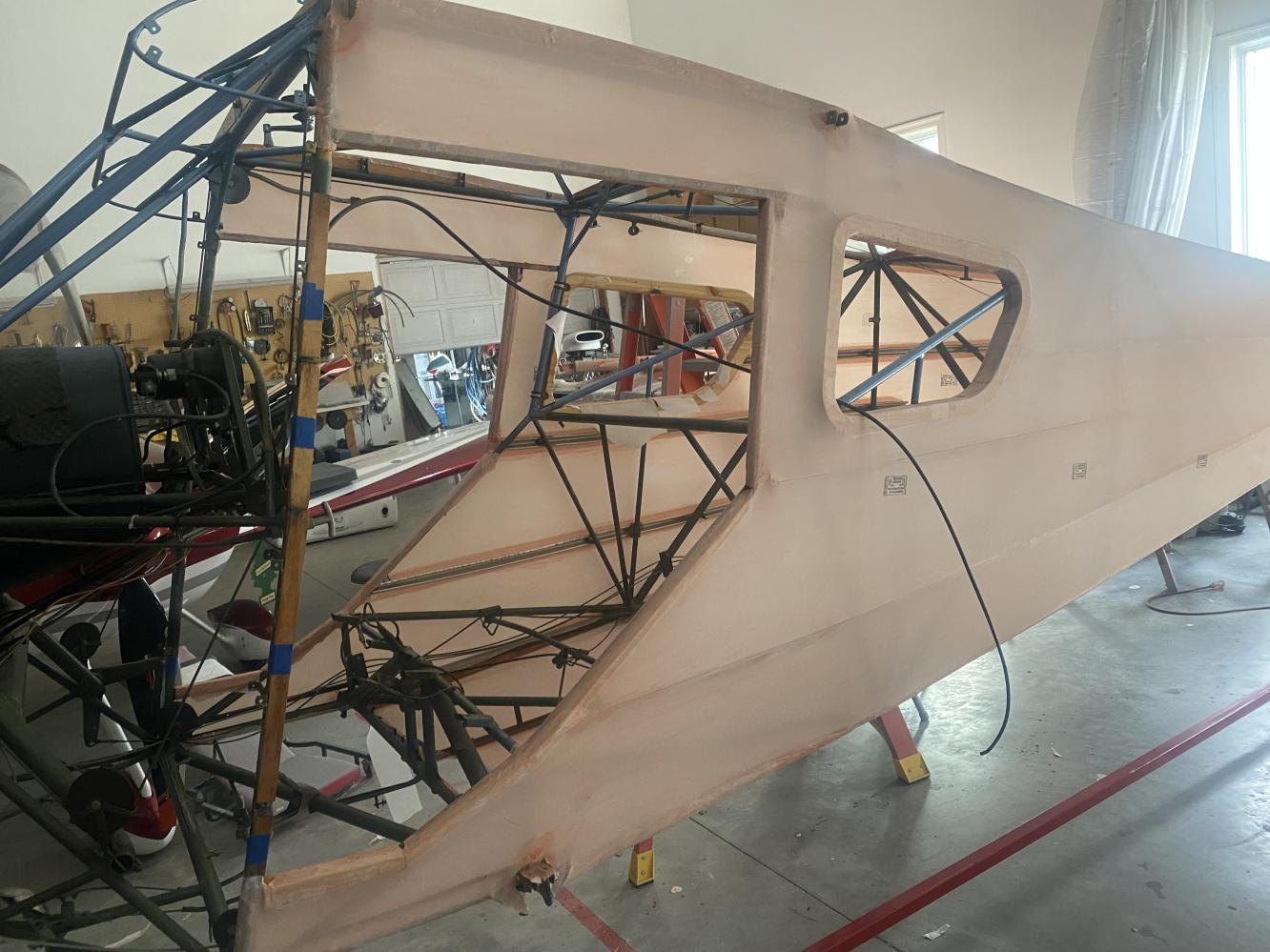

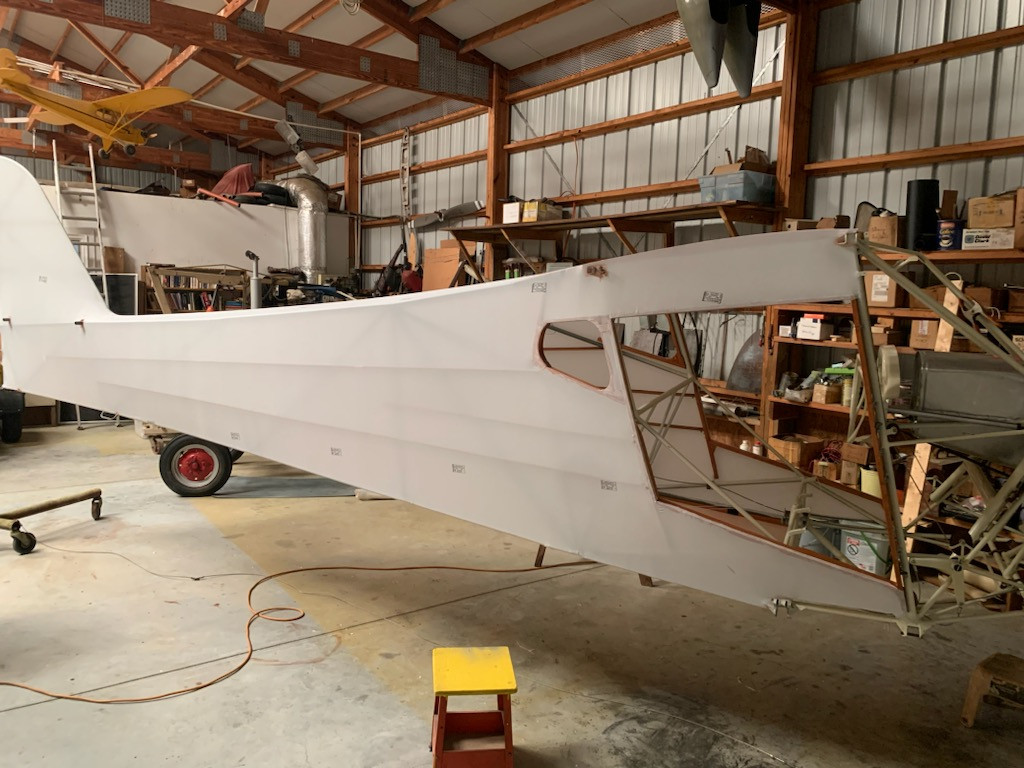

    FIRST stretch today! Click image for larger version

    Looks great!!! I am hoping to be on floats next April!!
      That part looks real familiar! Ditto looks great. Are you doing a full restoration?
        Sort of. Doing the 1941 deluxe upgrade to model 19 with the CAP STC’s with as many mods as I can get stc’s for
        skylite, wing mods for 1,500lb gross, large baggage. Back windows. 85-12 engine annd starter- already done. I have Trickair ski 337 and FAA field approval, shoulder harnesses, EDO 1320 straight floats. Working with Terry Boden on getting approval for heavy duty gear.
