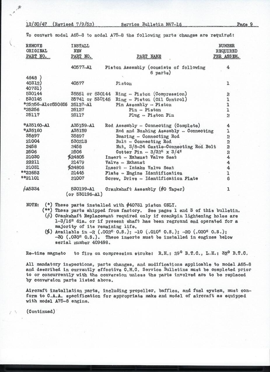

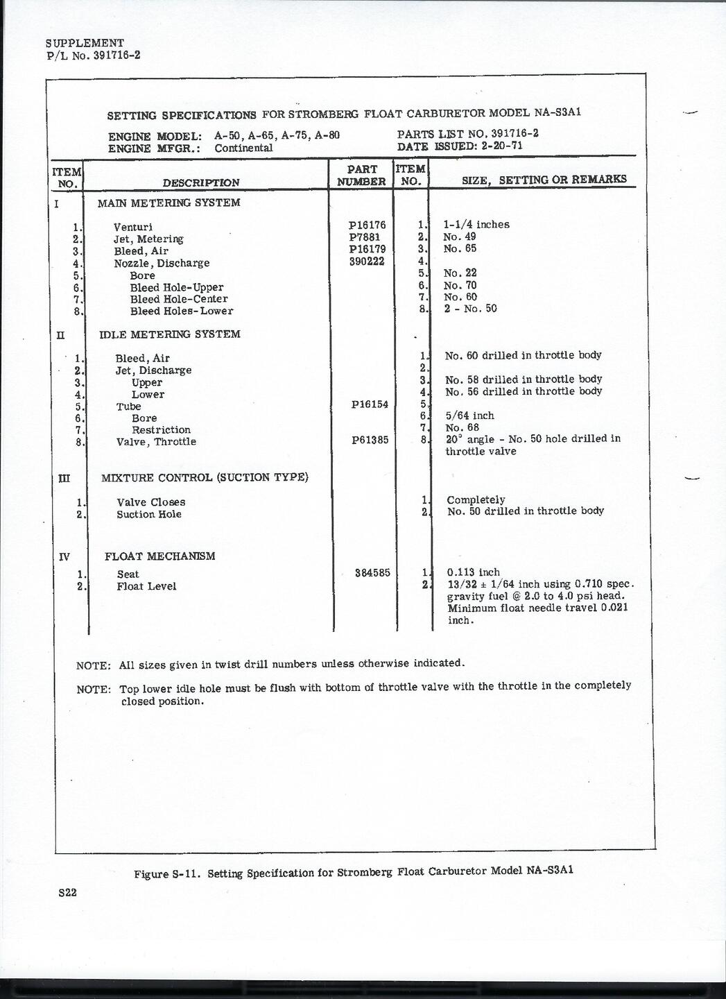

                          Harry Fenton knows a lot about small Continental engines but I think he is wrong about the venturi. I have 13 overhaul/parts manuals for the A65 A75 dating from 1941 to present and they all show the A65 and A75 use the same carb. Also continental service bulletin M47-16 gives instructions on converting an A65-8 to an A75-8 and no carb work is included. I'll attach that to this post. Also the Stromberg NA-S3A1 overhaul manual indicates that the A65 and A75 use the same size venturi. I'll also attach the spec page from that manual. Click image for larger version
ID:	194940 Click image for larger version
                            A couple of other A65, A75 points: The latest A65 piston p/n 40731 uses the large .9215 dia piston pin so if your engine has those pistons installed the rods will need to be rebushed to use the .859 dia pin for the A75 piston. If your engine has the earlier A65 pistons, p/n 4648 or 40312 these pistons use the .859 dia pin so there would be no need to install new bushings. Also there are two .859 dia piston pins, p/n A-21422 and A-25127. A21422 is a thin wall pin with an id of .626 and is subject to failure and AD 46-36-01 requires replacement with p/n A-25127 (.594 id). I've never run across an engine with the thin wall piston pin installed in the 60 years I've be around these engines but have been told there have been a few found to be installed after all these years.
