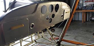

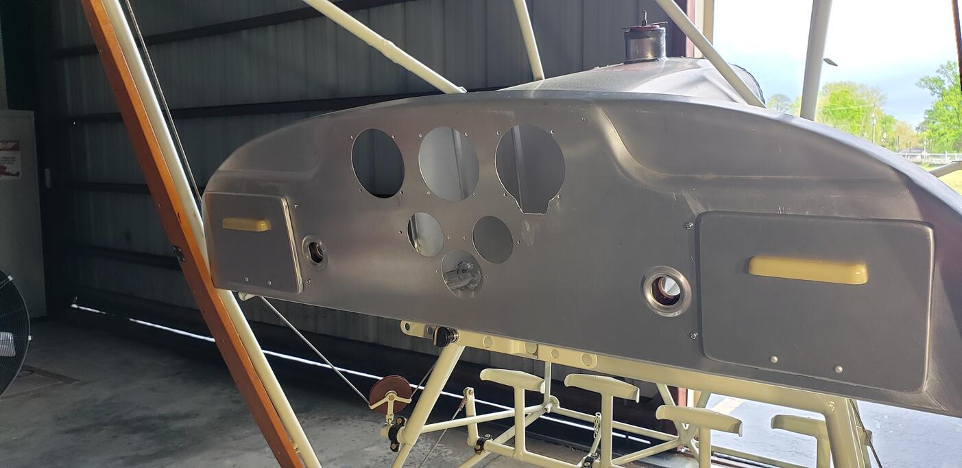

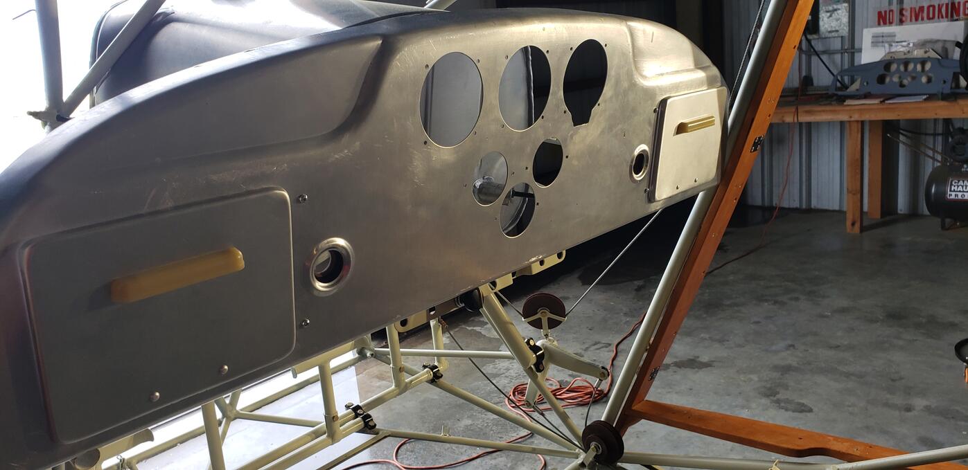

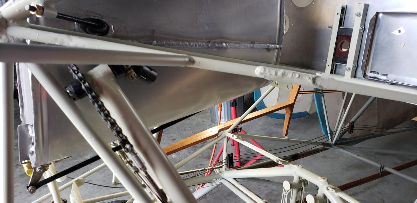

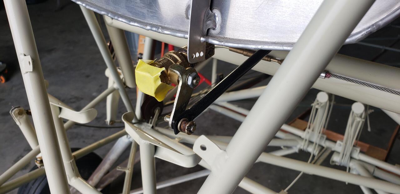

All the new cables and roll mark needle bearing pullys are in after the aerothane finish paint on the cabin area tubing was done. New fuel tank installed with Tim Popps new valve. Golve box re built on right side. New one made on left was yesterday's project from a shoebox. New panel is fitted and installed. Yokes stripped today Panel coming back off for primer and final sun valley ivory color in Aerothane along with the yokes.
New panel in etc
JIm, the work looks outstanding. Nice to see you have the turnbuckle on the back side of the H-column.
Also compliments on your neat & clean shop. What's the extra panel in the back ground, spare?
Keep up the good work! Post more pics, they are inspiration for my projects.

The shop is actually a T hangar.
The other instrument panel you see is on the side work bench. It is the original panel which had a venturi driven turn and bank and a vsi added in 1952 from what looked like a kit package from Pioneer Instruments. I knew the gent that added these as he was the planes owner at that time and an A&P that was still around when my father and his partner owned it. Three generations of my family have owned the plane at some point. My father, then to me and now my son.
Will continue to post pictures as time goes on. Slow proces between meaningful chunks to see. Fun no matter!
