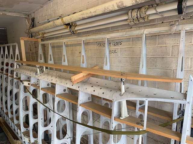

                              The second aileron spar finished today with all holes drilled and just awaiting a coat of West epoxy - Both were cut from wing spars and passed through a planer thicknesser.
