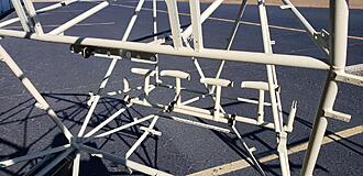

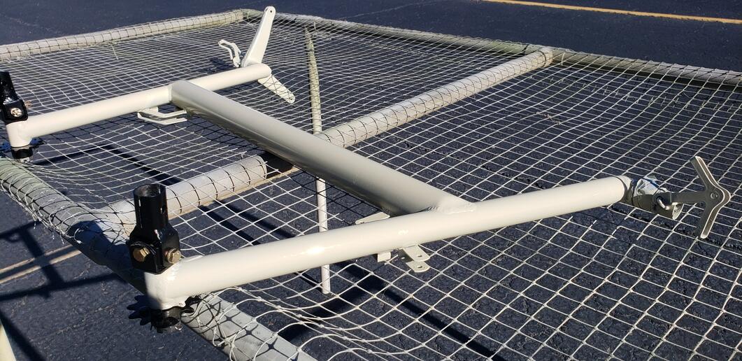

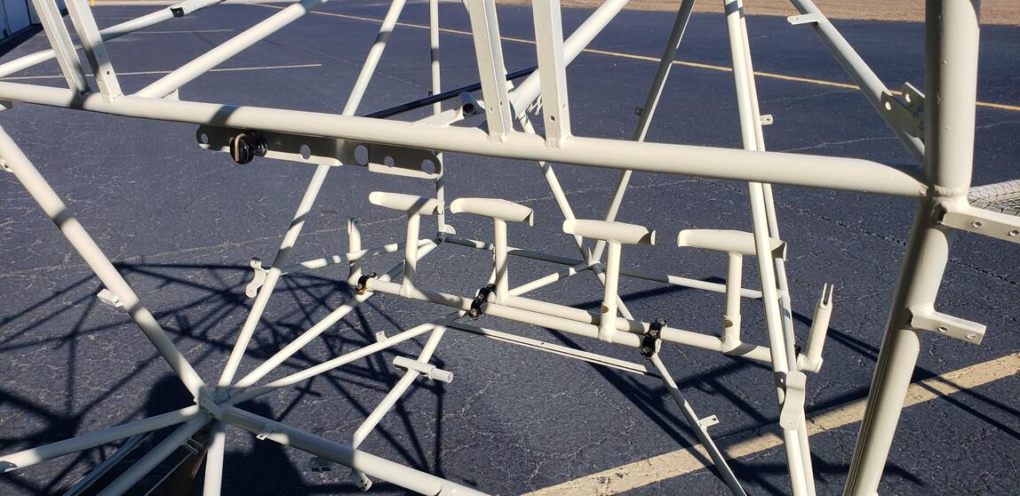

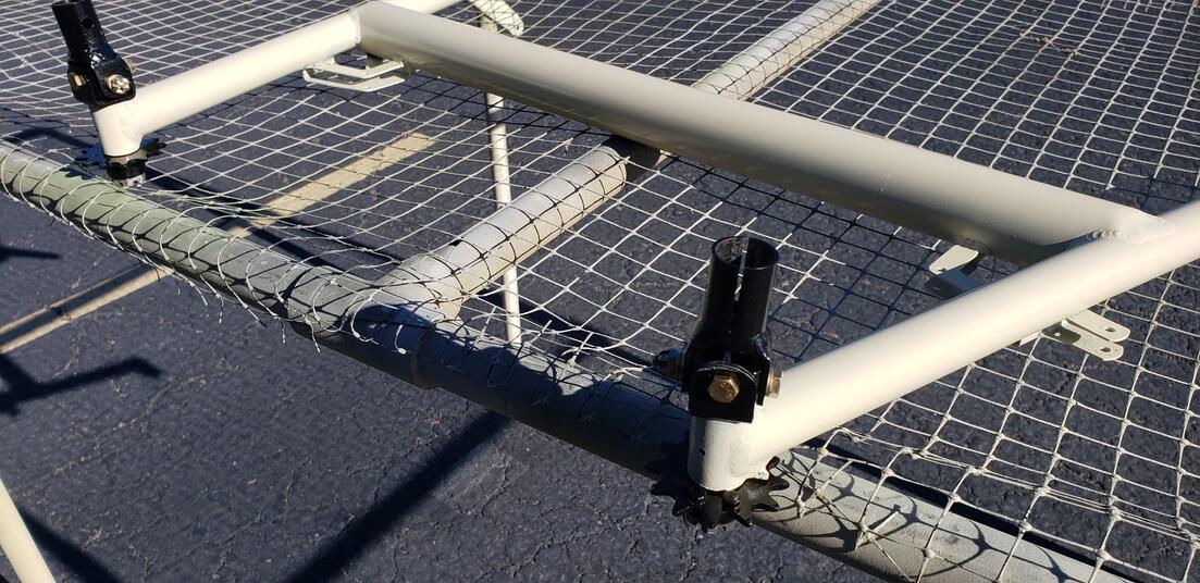

        H bar about to go back in after rebuild and paint. Rudder bars back in as well as fuel shutoff. . Door frame and top frame are next to install Click image for larger version

          Not too late to put some anti-slip granules on the rudder pedals. Mask off a 1/2" tall strip accross each pedal brush or spray one coat of urathane, add the granules and spray two more coats at the regular interval.
          The paint on the pedals will last longer and more importantly you'll feel sure-footed. Not a bad feeling to have in a Talorcraft.
          S
            Thank you for the thought Scott!
              There are actually two different types of coatings. One is Anti-Slip and the other is Anti-Skid. I can't remember which is which but one is a paint like material with grit in it that we used on deck surfaces in the Navy and the other is a tape material that can be pulled from a roll, pealed off and stuck down to a surface. The tape one is very easy to use and comes in all different sizes including strips about one inch wide that work well on rudder pedals. The advantage is if you can get your head and hands into the foot well the tape ones can be put on without the mess or masking. Your plane is still wide open so either one would work well for yours. If someone wants to put it on a flying plane the tape works much better unless you are "size challenged" but in that case neither method is easy. We operated jets and tow vehicles on the paint product and used the tape on lots of ladders (stairs) on the ships. Both were very durable.
                Good info on the anti slip stuff!
                All said doubtful that for now I will be using anything. If ..should I say when the paint comes off and begins to look seedy then it will be the grip tape that is applied.
                I do not recall foot slippage being an issue in the 200 hours in Taylorcrafts. Our pedals also were thoughtfully designed (as was the whole plane!) with the sides to them as well
                Again I always APPRECIATE comments that are wanting to help. For that I am eternally grateful. Doing this all alone would be a nightmare!
