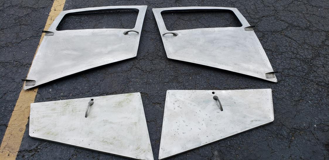

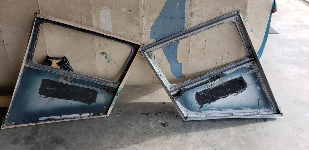

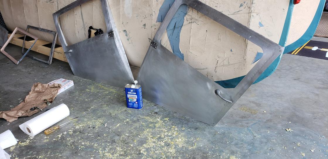

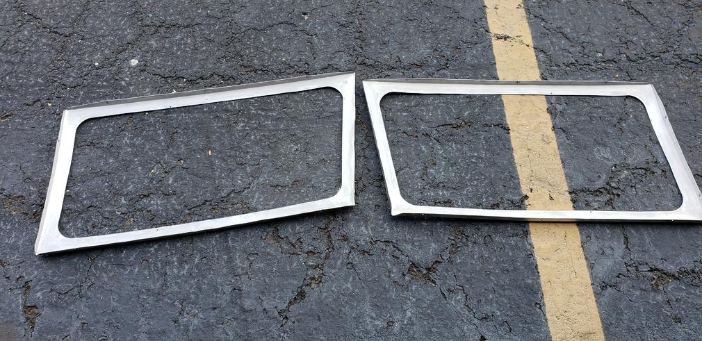

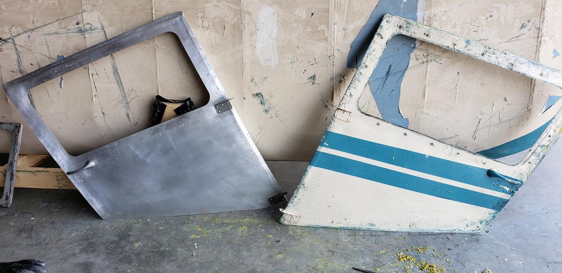

      Egads do it myself? WELL I AM ! Sorry my attempt at humor.. hire a "stripper" clean living clean living Robert ..... Thankyou for the advice however...just about have them done..
        Finished with that job thank goodness! Also a Bg thanks to Mike Redpath for selling the two door handles. Now on to door skin repair , new set windows. BTW what are folks doing for tracks?Click image for larger version

          Inside frames ....
            Ya have to have stripped them to understand.....
              DANG!! Those are going to come out NICE!
                Thank you Hank. I am not going to pile on door interior on top of the metal interior door panels. Simple , straight orginal and light is the key!
                  Check for any dents and damage to the inside. Sometimes a thin vinyl upholstery can be lighter than (God forbid) a slather of Bondo to get the metal smooth. You can also make a NON STRUCTURAL filler from a little (as little as possible) thin epoxy mixed with micro balloons.
                    Original is key. Simple , light as possible. In a word....Taylorcraft. Shame that so many are so far from what they should be. Just one man's very humble opinion.
