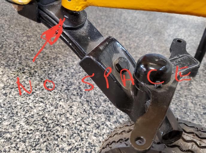

rudder horn touching tailwheel
  • rudder horn touching tailwheel
    Should I just add spacers until the rudder horn clears?
    your spring is probably worn some, and you can add some 1/8" rubber. I would get a new spring and then add the rubber. Mine used to hit, new spring and rubber gave me about 3/16" clearance. Tim
      Also check the rudder hinges. The weight of the rudder wears the hinges such that the rudder ends up with vertical play ie the rudder gets lower ( as long as you're pulling positive G's
      S
      Scott
        thanks all.I installed a 1/2 inch Block to clear the horn..
