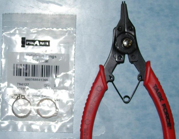

    I think I got the same fairleads you did and they were loose. The big problem was the snap rings they furnished were junk.
    This is what I ended up using and it worked great.

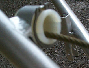

    Wayne Melvin
    N43112
      another shot
      This one shows the fairlead in place with the clipring.
      Hope this helps.
      Wayne Melvin
      N43112
        Wayne,
        Perfect! It has been awhile since I submitted this post and I was beginning to think I was going to come up dry. The fairleads do indeed look exactly the same as the ones I purchased and I was thinking if I could find different clips, I could still use them. Did you get them from any particular supplier?
        Grant S. Bailey
        C-FXSU
        1951 Model 19
        Delta, B.C.
          clips
          Any good automotive shop but I got mine at Home Depot. I guess I am not supose to say that.
          Wayne Melvin
          N43112
            A double wrap of .032 safety wire one one side then cross over to the other side & do the same works good too! ---Publicious says
