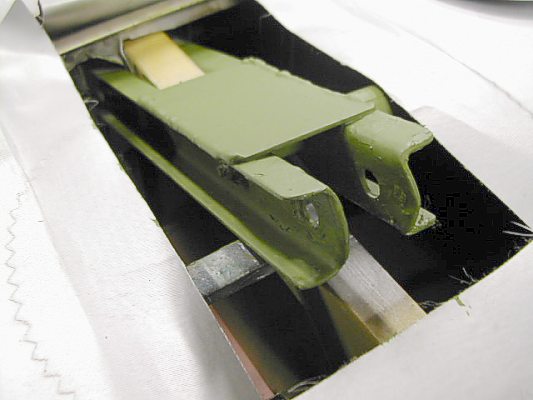

    Just had an interesting experience this evening...
    As part of my 85 HP upgrade, it was finally time to weld the little steel pieces across the strut fittings.
    You may remember that last month I had washers welded onto the damaged wing attach fittings. Using TIG welding and moving slowly, the washers were able to be welded without burning the paint one inch away from the weld point. We used lots of wet rags and reflective heat shielding, and the heat transfer from the weld to the surrounding metal was a small fraction of what it would have been using gas welding.

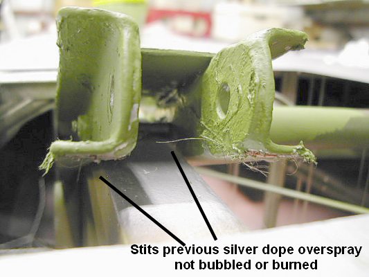

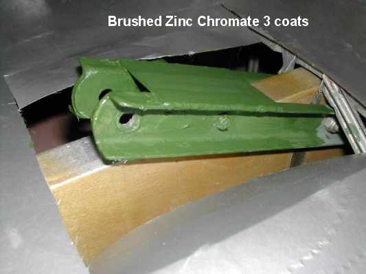

    This evening, we started to weld the strut fittings while they were still installed on the wood spar! We used wet rags and aluminum heat sinks clamped to the fittings, and woven asbestos hot-rod header wrap soaked in water on the spar surface. The welder worked very slowly, meaning that he quickly welded about 1/4 inch at a time, then backed off and I put wet rags on the joint to cool it immediately.
    By being really careful, we welded one fitting in place on the wing, and the varnish on the spar was not even discolored, the Stits silver dope overspray on the spar was not bubbled, and there was almost no heat transfer. The spars never got much over "warm" to the touch, We did a close inspection to see if there was any discoloration or bubbling of the varnish. The secret was doign a little at a time and my being real quick pouring cold water on the rags as soon as he stopped welding.
    Needless to say, this saved me a lot of work disassembling the compression strut and fittings from the spar, and moreover it removed any chance of the bolts not wanting to go back in. Most people would agree that is is OK to "tack weld" the fittings on the corners and then remove the fitting to finish weld. All we're doing is tack welding, then cooling it off, then tack welding some more.
    Of course this method is more risky than removing the fitting, but if your welding technician is good it can save a bunch of time. This is not for brand new welders of course, but in this case I am convinced it saved me a week of time.

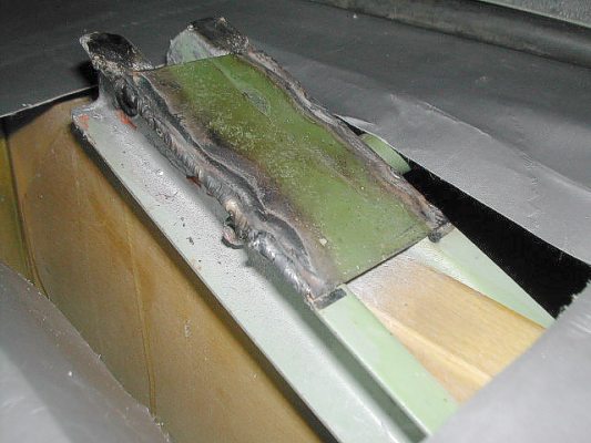

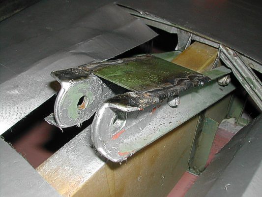

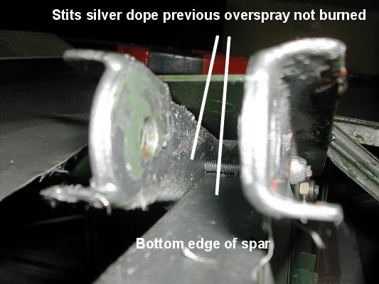

                We finished the in-place TIG welding project the other night. A close visual inspection revealed that we managed to join the strut fittings and the reinforcement plate with no damage to the spar.
                There was no bubbling of the epoxy varnish at the intersection of the metal fitting bend radius and the spar, which I think is where the heat would have been worst on the spar. It didn't even harm the little bit of Stits silver dope overspray, which should have been the first to melt because it is lacquer based.
                I was fortunate enough to be able to see underneath the reinforcement plate with an inspection mirror, and noted no damage on the bottom edge of the spar. Close inspection revealed that the area of bubbled paint on the steel fittings under the plate was limited to less than half an inch from the weld itself.
                All in all I believe this method gave me a successful result, although if I had it to do over again I might choose to remove the fittings. The emotional stress and worry was significant, and the time it took to go through the weld process very slowly was perhaps more than the time it would have taken to remove the fittings.
                It CAN be done this way, without disassembling the wing, but there was not a huge savings of effort after all the beans were counted.

                    Here are some photos of the process. Note the short distance from the weld where the existing paint was not burned or bubbled. We used lots of wet rags as heat sinks and direct application of water to cool the steel between the weld and the wood.

                          The results of an inspection by a VERY qualified facility have shown that the TIG weld we used to put on the reinforcement plates was faulty. There was "porosity" in the welds.
                          This may have been caused by my over-zealousness in cooling the weld, it might have been poor welding technique because I was pestering the welder to do it much more quickly.
                          But the bottom line is that it was a serious MISTAKE for me to have tried this, it made bad welds, and it was found to be NOT SAFE. The parts were disassembled and re-welded off the aircraft, and will be normalized, eddy current inspected, and epoxy primed.
                          Once again, my thanks to the people who took the time and effort to send me a warning that my big idea may not be safe. You all definitely were thinking in the right direction, and I'm glad I was not too stupid, arrogant, or pig-headed to listen.
