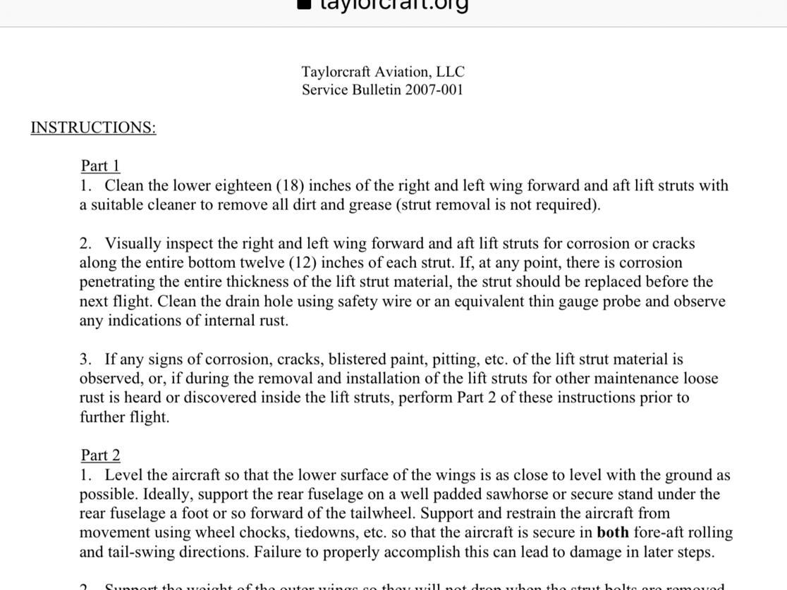

        The last sentence of paragraph 2 implies a drain hole.

          Yes the last two sentences indicate that there are drain holes.
          I said in my reponse that my post war planes had drain holes.
          Your question in message #1 "Was there a factory service bulletin suggesting drain holes in the old non-sealed lift struts?".
          I assumed that by using word "suggesting" that you were meaning "suggesting creating" or "suggesting installing".
          I don't know what you are asking, if you had that 2007 SB already, what are you asking about? Yes they had drain holes. No I am not aware of any SB instructing to create drain holes.
          The existing drain holes most likely were done during manufacturing process.

            Yes there was a bulletin. I don't have time to look for it right now. It was a 3/32-1/8" hole on the bottom of the strut.
              I missed that one.
              Must be fun drilling the hole in the trailing edge. I bet I would have drilled a finger at least once!
