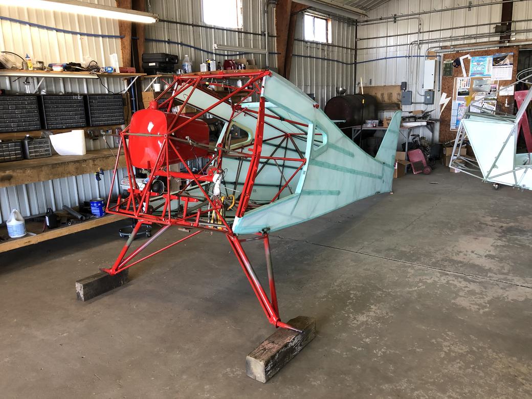

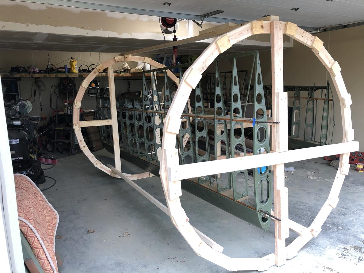

      DB8AEABD-EE43-4DAF-AB0F-9EC02EB0066F.jpegC5C74A47-0625-460C-8710-7A5FCA75BA75.jpeg I am rebuilding my Dads BC12D that he owned for 50years and I learned to fly in also. I live in the very SW corner of Wisconsin...about 3miles from Dubuque (Rigdon Private on the Chicago Sectional)
      Like yours this sat for about 20 years after I took the wings off and stored in the garage to protect my inheritance...I mean the plane...from keeping the hangar from falling in on it ( it hadn’t flown legally for about 7yrs prior to that)
      I am not going the direction you are with yours but we do have some parallel paths to follow if interested stop on in or give a call
