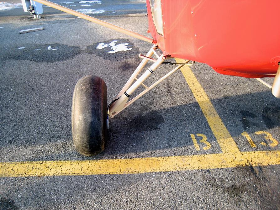

                Your planned fix will work well Adam. If you can afford it have Atlee add the small cross tube to brace the diagonal - the lower to upper cluster tube - and some at the wheel to prevent twisting on skis. Cub gear typically has the lower stiffeners. My Taylorcraft is the last plane at the north end of the float pond - tan and red. I'm getting older and don't fly as much as i used to but hope to get on floats again this summer.

                  Nice setup, financially it is tough but I might as well do it right. Plus I would like to get skis on it next winter. I will pass this along to them.

                    Atlee's Repair Station did the gear work Ref. invoice #71809 8/8/2011. There's no appreciable twist to the axle on skis. The lower bolt for the wheel fenders remains intact. They now offer a clamp-on fueling step if needed.
