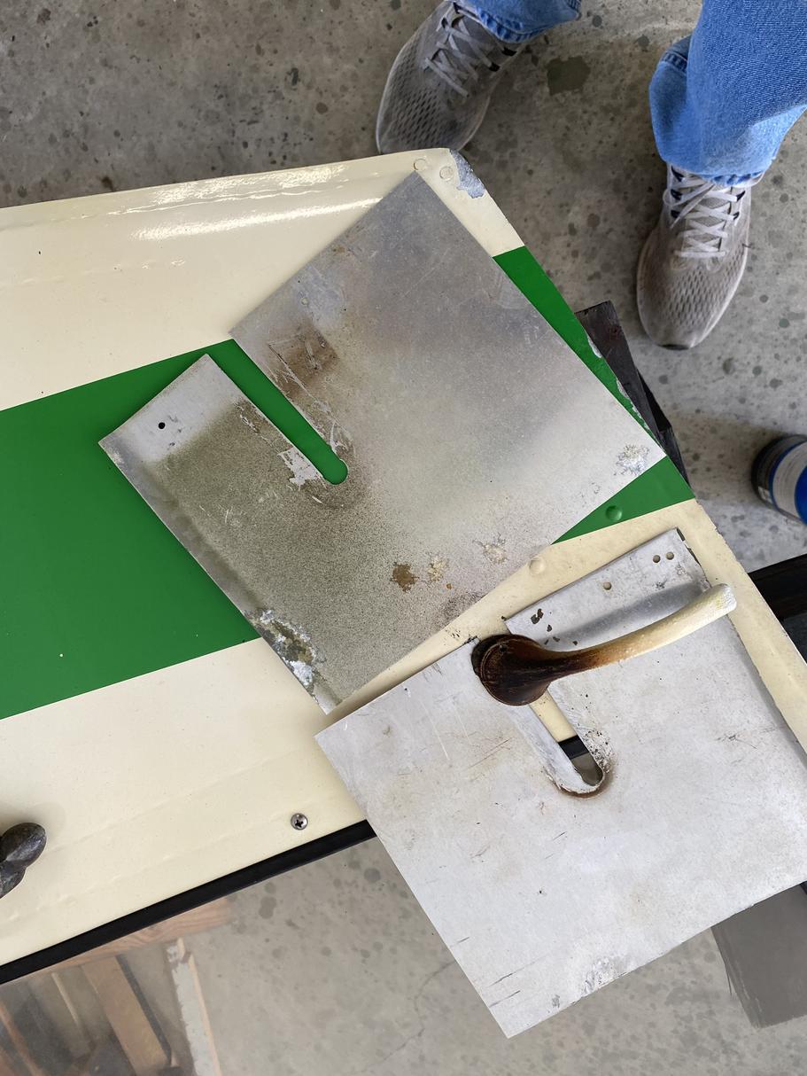

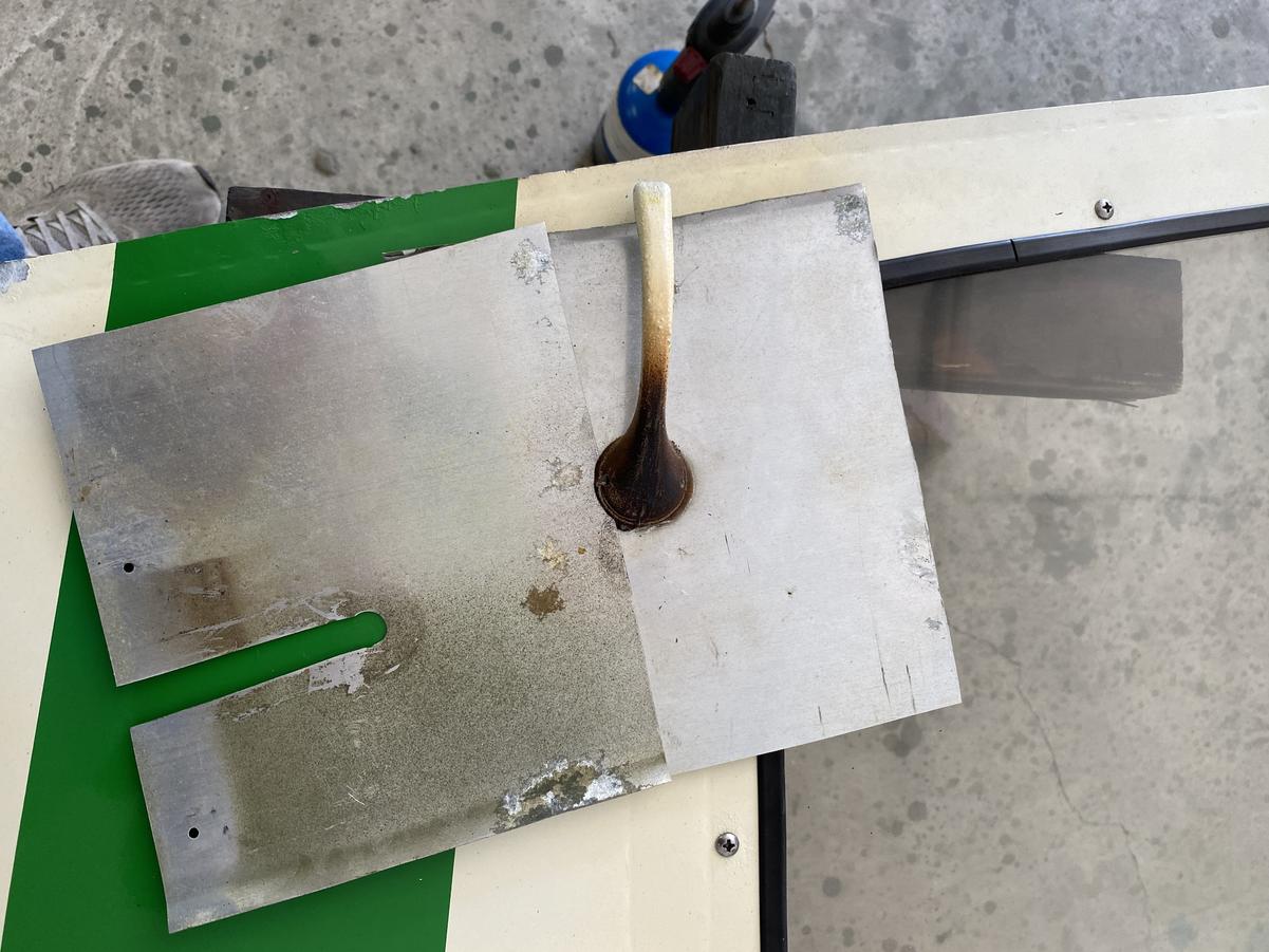

    I have heard all the horror stories about removing door handles. During my rebuild I needed to remove the door handles. I tried using a punch with no success. I have 6 doors so I thought I would try on one of the less desirable ones. After much beating nothing moved. I made a couple of heat shields out of .025 aluminum. I slid them between the handle and door. I applied heat with a propane torch for about a minute. It was too hot to touch. I used a 1/8" punch and a small hammer. I was able to remove 12 handles from 6 doors and did not damage a single one. You might want to give it a try. Most pins are inserted from the top down so drive them out from the bottom. Some had roll pins and others used solid pins that looked like cut off nails.

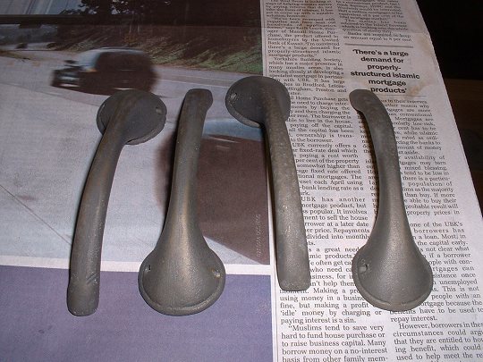

            I had no trouble getting my magnesium door handles off (fifteen years ago mind you)
            Story here:https://www.taylorcraft.org.uk/Brey_...oors.htm#Doors
