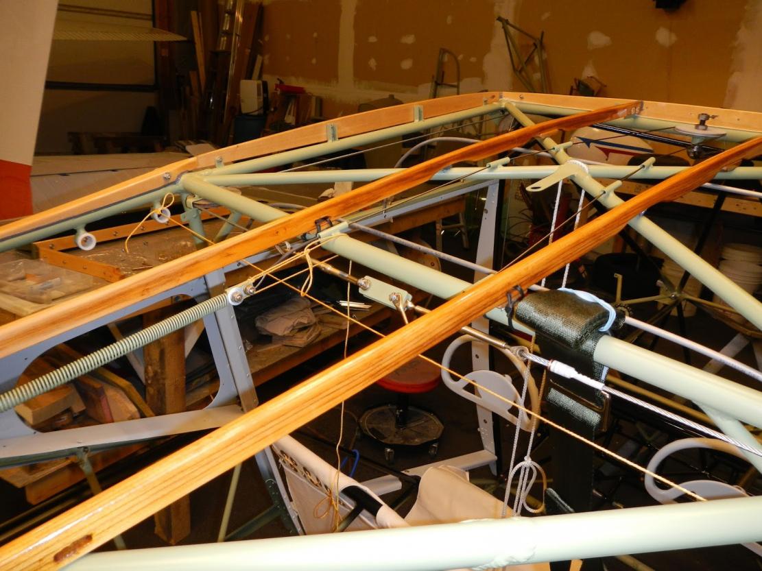

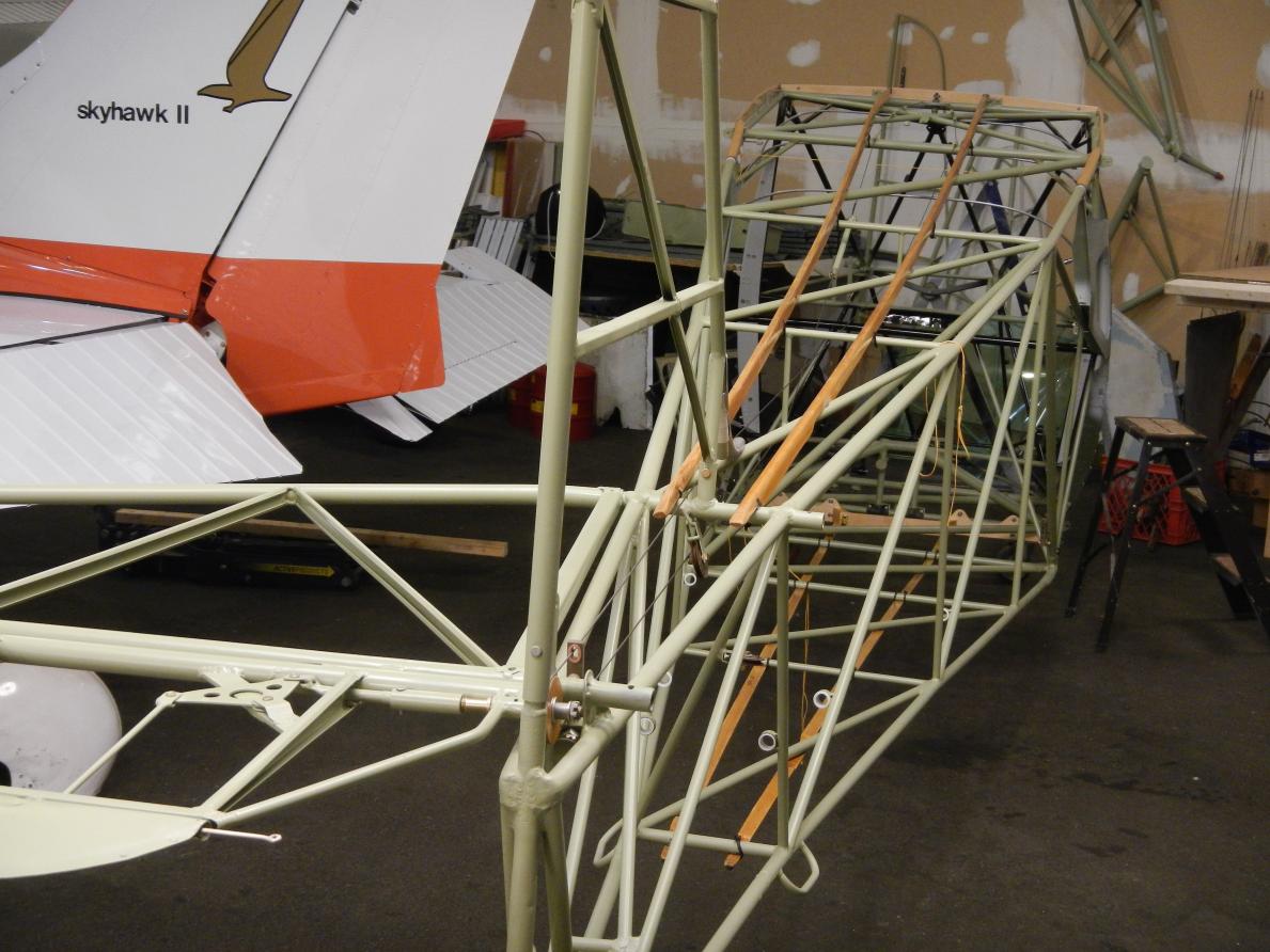

    Does anyone have pictures of the elevator trim cable springs locations?
    Thank You
    Or what side does the springs go on? Pilot or copilot side?
    Thanks
      The pilots side. I goes between the rear spar carry through and the longer cable guide in the rear of the fuselage.
        This should get you started. I'll try to find more
          Should be able to zoom in on this shot and see the routingClick image for larger version
            Perfect, Thanks for the help!
