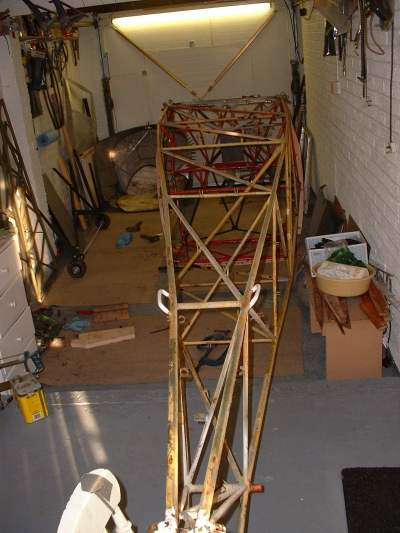

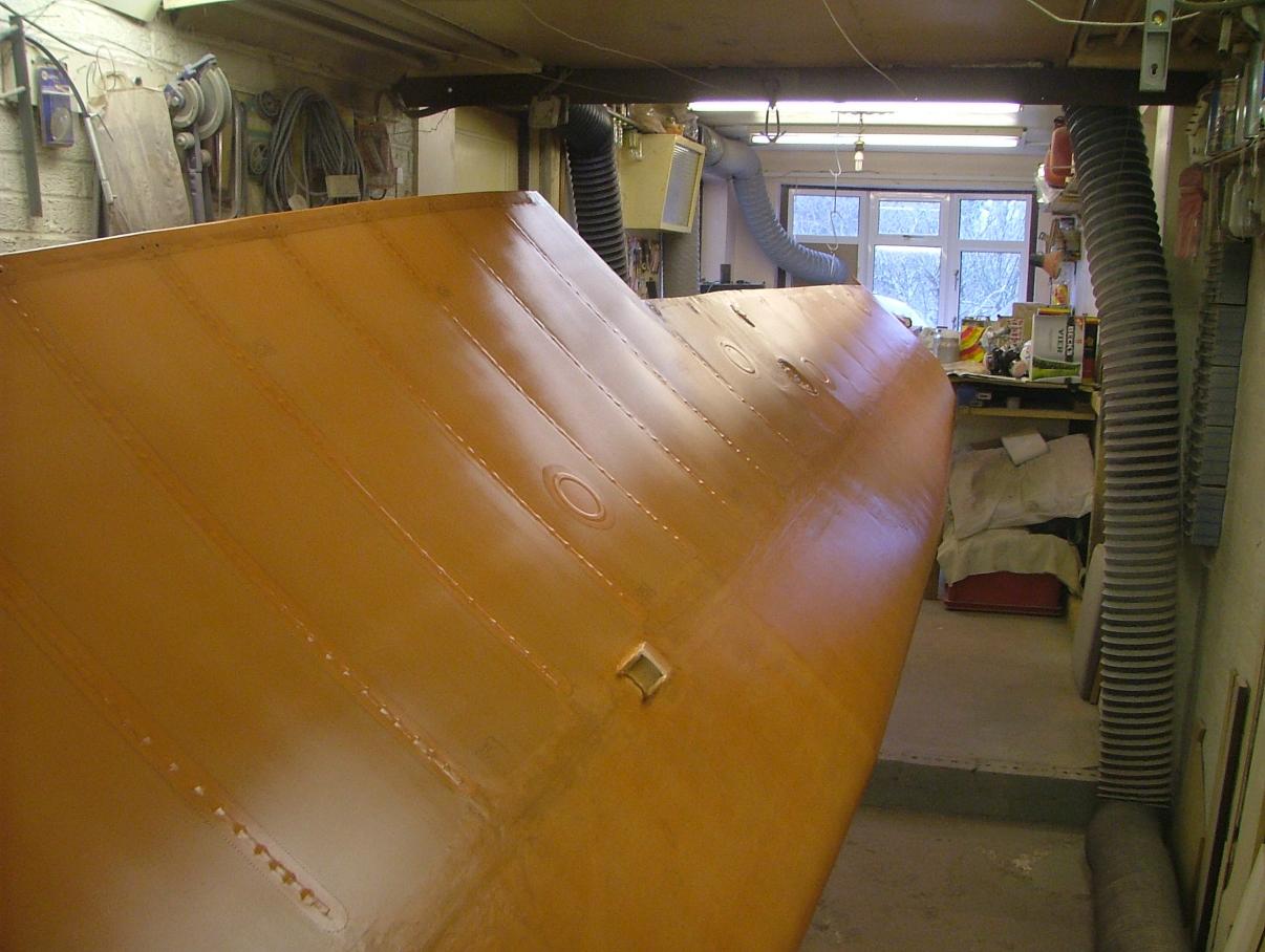

        BlueRidge, I rebuilt my Taylorcraft in an 8ft-wide garage, 8ft high, but 36ft long (so like a "tandem" garage"). I could obviously only work on one item at a time, but it can be done in a residential street.
        I have since rebuilt several accident-damaged Pitts Specials in the same garage, and also a Putzer Elster, each wing is 21 feet long.
        In answer, build as large as you can afford/have the ground for.
