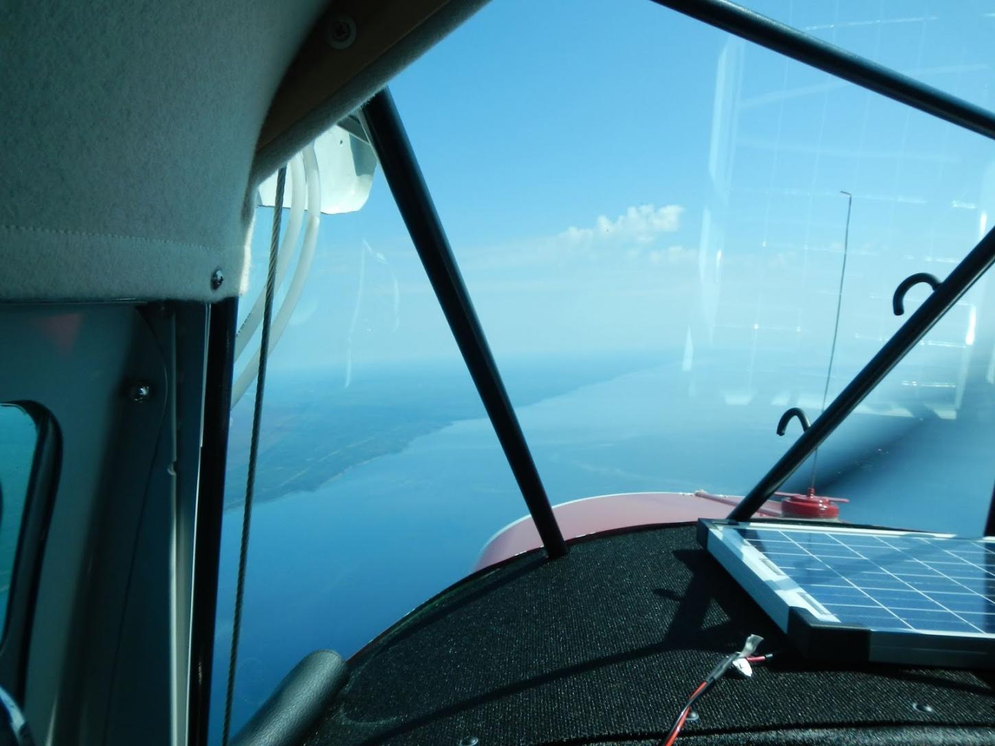

    I should also mention that I charge the lithium battery with a 10W solar panel, in the air this slows the discharge rate when I'm using the comm, transponder and ipad. On the ground it brings the lithium, ipad and cellphone back to full charge.

        Hank asked me about the solar setup.
        I was actually looking for a thin flexible panel, but then this Coleman one went on special for $28 (US$20), and I was short of time so I tried it. It's rated 10 watts. I put some velcro on it and it fits between the compass and fuselage tubes.
        The Lithium battery I got from amazon; name is Talentcell and rated 11000ahr at 12V. I'm cautious about lithium batteries but this one reportedly has Panasonic cells in it (I have not dismantled it to confirm). It has a USB power output as well for charging ipad cellphone etc.
        The Battery manufacturer does NOT recommend charging with a solar panel. Having said that DC voltage is DC voltage regardless of the source and photo voltaic cells produce clean current. So I experimented a little.
        I have the panel connected directly to the battery pack (no charge controller note: the panel has an internal diode).
        In the air, with radios on and ipad connected, the solar panel raises the voltage a little, but the battery continues to discharge. This means the output from the solar panel is simply supplementing the battery output extending the discharge time. Importantly there is no charging so no potential for over charging, overheating or over anything (most, but no all of the risks with lithium batteries are associated with physical damage to one or more cells and over-temp due to high charge or discharge rates). The solar panel effectively reduces the discharge rate therefore reducing discharge risk. Air time from YQT to OSH was 4:20 and lots of life left in both the battery and ipad. (on the bench this battery powered the Transponder and VHF in receive mode for 24hrs)
        On the ground, with the solar panel connected to the battery and nothing else, even in bright sunlight, the voltage remains under the max voltage measured during charge from the wall charger. It takes a few hours but does bring the battery to full charge. I monitored it at OSH for a week and even with both the battery and panel in bright sunlight no significant temperature rise was detected. In practice I place the battery under the panel (a good distance away from anything flammable).
        So I would class this as experimental, but it does make for a light and effective package.
        Difficult to see in the photo but I attached an angle to the hinge screws. The radio package goes in over, and drops behind, the angle, then the battery slides in on top "wedging" it all in place. I usually have the door on so all but the solar panel is out of sight.
        This is a "portable" solution if anyone's wondering about certification
