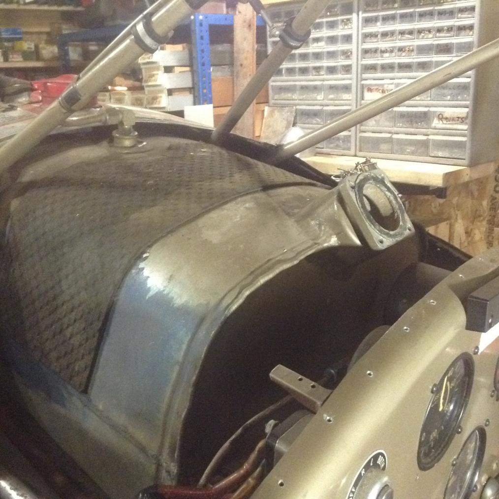

    Anyone have any suggestions for cleaning my main tank in place? Very light rust flecks and lots of white powder light residue. I am hoping someone has had good luck with a cleaner? I have a temp fitting and valve on the outlet so that I can rinse and flush.

      image.jpeg Thats a good idea. I would feel better If I could somewhow wirebrush the entire inside and then flush with a cleaner that would remove any remaining residue. Is this an F-19 or F-21 main tank? At one time the plane was set up with the Harer 85hp conversion.

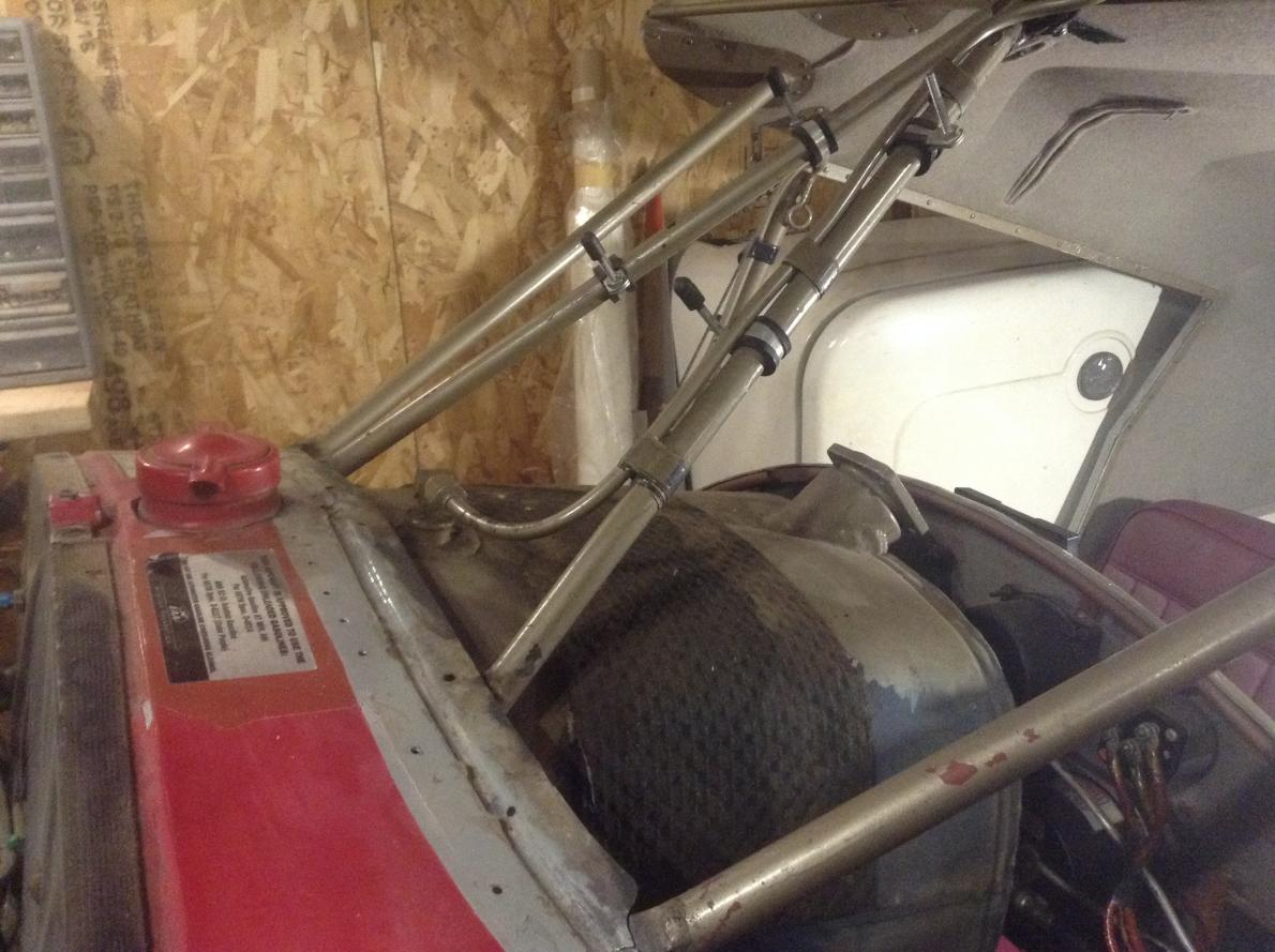

            Is that a Taylorcraft tank? Looks like what I've seen on Aeronca Chiefs with the fuel gauge near the instrument panel. Just curious but look up that plane for pics.

            Edit = Alternatively someone from a time long past welded an Aeronca fuel gauge on a Taylorcraft tank. A gauge on the tank is required as part of Harer's STC SA1-210 C-85 conversion along with a vent line to and between aux wing tanks, plus a sealed filler cap. The typical gauge is a Rochester round unit near the vent outlet like the F-19s used. But back then common sense and ingenuity prevailed.
                  I've never seen that part of that STC and I've done a few. Did I just sleep through it?
                    I believe it was either added to the STC or was a subsequent compliance option when the CAR 4 BC12D-4-85 and CAR 3 Model 19 equivalents were added in 1971 on the STC. Probably applies to later -4 motor setups with the long mount and others. Under TCDS 1A2 required for the Model 19 and F-19: Note 2. (h) “Main tank usable fuel 9 gal.” (Must be displayed above the fuel selector valve) How else would that minimum quantity be measured?
                    It was done to mine during restoration so maybe they did it to comply with the placard's requirement. The setup matches F-19's I've seen. See Page 8 for 85HP, F-19, F22:
                    http://www.univair.com/content/partc...nteractive.pdf
                    And here Page 5: https://www.taylorcraft.org/docs/Tay...anual_1985.pdf
                    Unlike earlier CAR 4 planes, for the CAR 3 Model 19's 1500 GW a Flight Manual was included in my STC.
                      My BC12-D -65 was partially restored many years ago including a new fuel tank from the factory while they were still in business. It has a replacement tank from the factory with the F19 configuration. I have to believe that that was the only tank available at that time and that it was OK to install it. Somewhere, I may have some paperwork about it. One of the apparent requirements was to have a vent tube run up inside the cockpit along one of the brace tubes, and go through the ceiling with a bent vent tube facing forward on top of the cabin. Otherwise, the installation is the same as what BC12-Ds had originally. This does away with the cork and wire fuel gauge in the filler cap. Since I am in an extended period of repairing this plane I only flew it a time or two when I ferried it from Northern Indiana to Terre Haute for the former owner and rode around with him a couple of times getting him fal\miliarized with the plane before he wrecked it landing in a muddy field across corn rows and damaging the landing gear fitting on the right side and the left wing rear spar at the root.
                      Larry Wheelock..
                        Larry I've I think I've seen the single vent tube with forward vent (adds air pressure for full fuel flow at high AOA and power) plus a lower sealed cap to maintain that pressure differential. If wing tanks are added under STC SA1-210 then their fuel caps require that forward vent design. The STC has a drawing for that mod but I have Atlee Dodge Cub caps that are similar and comply with the requirement.
