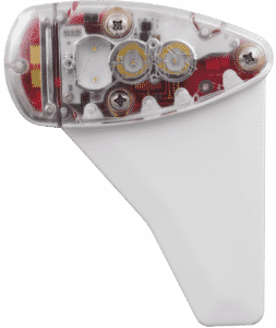

    I am now an Approved Installer for the Uavionix Sky Beacon ADS-B out system... This seemed like the easiest solution for several of my customers already. This thing just replaces your red nav light and works in conjunction with your old transponder. I can install it on just about any aircraft that does not have the tail light as part of the nav light or something that has tip tanks that gets in the way....I hope to have pricing next week. Tim skybeacon-tso-strobe-1163x1380-253x300.png

          skyBeacon is ADS-b out only, not transponder, if you use it with a transponder it obtains the transponder signal and data thru the electric power wires that feed skyBeacon.
          Here is a snippit from their manual about it;
          6.3 Power Line Transponder Monitor
          skyBeacon utilizes uAvionix’s Power Transcoder to ensure proper synchronization of data elements between Secondary Surveillance Radar (SSR) replies and ADS-B transmissions. These elements include Mode A squawk and IDENT status. In remote areas where you may not be interrogated by SSR, these data elements may at times be unavailable. The Power Transcoder additionally serves to provide Continuous Calibration™ data to the altitude encoder.
          I don't think skyBeacon itself will ever have to meet the transponder check since it's not a transponder.

                    The strobe will only work after the unit has been programed. I was in the hanger and installed the unit on my Cessna 152 and went to test the strobe before I reattached the wing tip, it did not work. In programing the unit you have to " tell " it to turn on the strobe. Then when you turn on the strobe switch the strobe will work.
                          Yep, that sounds correct (assuming the strobe switch sends 12v to the wingtip).
                          Same story for the nav-lights.
                          Dave R
                            Dave,
                            I was going to ask how you disabled the nav light. The nav light must be programed to illuminate? The strobe would not flash if the power lead is not connected. Correct?

                              Mike,
                              uAvionix has an app that runs on iPad and iPhone.
                              Download the app then program the skyBeacon. For the first 5 minutes after skyBeacon is turned on it runs a wifi that you connect to.
                              While connected you program the skyBeacon. the wifi runs as long as you are using it and apparently 5 minutes beyond when to you stop using it
                              You program the nav-light on or off with that app.
                              If it is programmed "on" then when you apply power to the red wire on skyBeacon the ADS-b and the nav-light turn on.
                              If programmed "off" then only the ADS-b turns on when you apply power to the red wire.
                              The red wire would get connected to your old nav-light wire.
                              There is a yellow wire that powers the strobe, it is supposed to have switched 12v or 24v not high voltage strobe supply.
                              The strobe works logically the same as the nav-ligth and has it's own yellow wire supply. I wrapped the red and yellow together and then programmed both lights "off".
                              I am thinking about programming the strobe "on". The thing only draws ,5 amp with every thing on and I recall measuring about a .3 amp adder when the strobe went on. So with a 15 amp-hour battery for the starter the strobe is "affordable".
                              Each time the skyBeacon starts you can reprogram the lights because each time it starts you can reconnect to the wifi.
