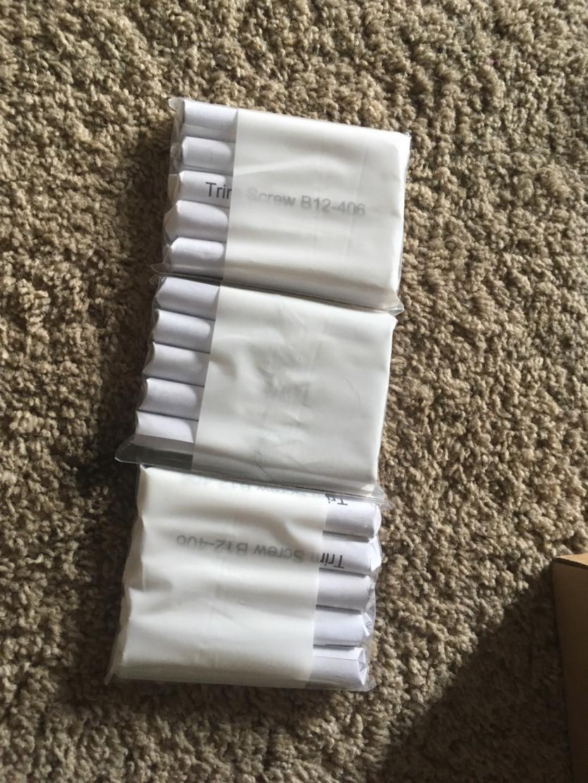

Trim screws came in, these are a package deal, barrel and screw for 175 + shipping. This is an owner produced part, so no paperwork but i can provide the material spec if someone absolutely needs it. PM me your address and I will ship them out USPS priority mail. As an owner produced part, you as the owner/operator will need to do a dimension check with your mechanic to install. Tim
Oh and if anyone thinks its too expensive, a machine shop charges $105 per hour plus materials so I tried to keep these within reason on price and allow me to make a little something on them. Tim

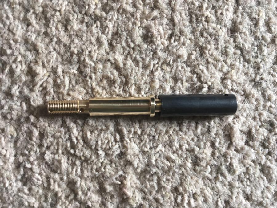

These are made from 485 brass. Also known as high-leaded naval brass, 485 brass contains lead for good machinability. It is commonly used for marine hardware, valve stems, and screw machine products. Yield Strength: 25,000 psi. Specifications Met: ASTM B21
Standard 360 brass is only 15,000 psi yield, so the 485 best quality brass for wear long term. Hardness is the same for all of the available brasses in the size used to make these.

Gary, I am not sure what you mean, but I use a heavy oil when I assemble them...the brass is not sintered so it does not self lubricate, that is a sintered bronze thing used in bushings.
