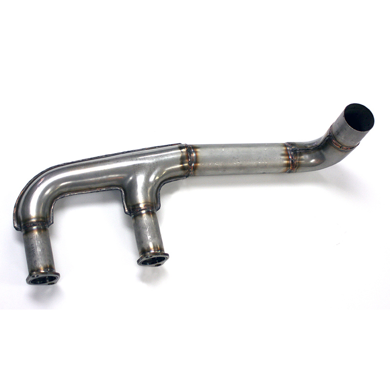

      What current exhaust P/N's are on the Taylorcraft?
      It has a system similar to this, https://www.wagaero.com/engine-parts...stem-a-65.html
      Except it has stainless pipes instead of mild steel.
        Maybe some of these in stainless? It'd be nice to have some FAA/PMA approved P/N's available for the process like those listed below.
        Piper J3 Exhaust System New Manufactured, FAA/PMA Approved, Stainless Steel Original Design, Exhaust Headers and Muffler with Safety Bail already installed.

          At least one section of the shroud still has a PMA sticker on from Aero Fabricators. I think the rest of the exhaust is also from there. They do also offer a stainless PMA'd stacks.

            Well that's a good start. It seems locally that the FSDO folks are strongly suggesting there be some supporting data or documentation for alterations. That exhaust system is well proven with known warts. I'm actually surprised that someone hasn't done more of the same with Piper products given the age of Taylorcraft exhausts. A DER may be able to cut through the process quicker than the furloughed FAA that will have a backlog when the fog clears. Once that's done others may be able to use the product. For this plane how you avoid excessive additional expenses getting there may be a challenge.
              I finally got the field approval for my exhaust. No real problems, but it did take a while. It had to go the ACO. The PMI I was working with is new to the field approval process, and was a little unsure of what needed to be done in this situation.
