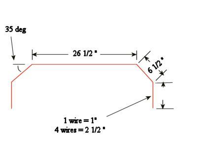

    Here is a diagram of the headliner wires. Four are the same, one has a different length for the ends.

        I have ordered my new headliner and need to make the wire braces.
        The problem I am having is locating 1/8" stainless wire that is long enough.

              That would be great! They need to be 54 inches long.

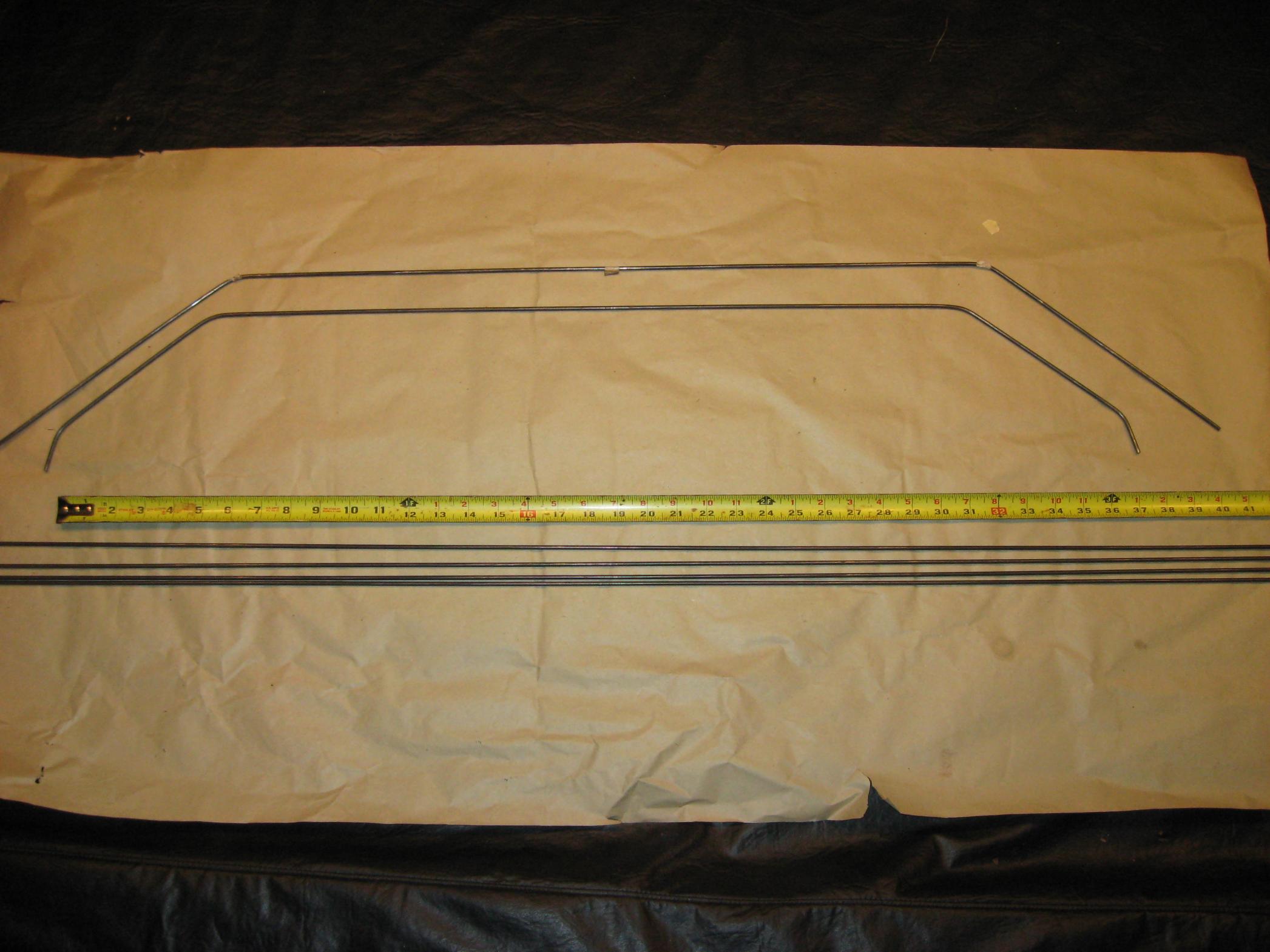

                Mine came from a welding supply store (I used to own one), and are 36" long TIG stainless wires which are butt-welded together to make long enough. The small weld won't show. Most any easily weldable alloy of stainless will do, whatever they have, most likely 308, 308L or 316. Mine have lasted almost 30 years now.

                    I used a wire that I got from a auto upholstery shop that is use for headliners on antique cars and trucks. This wire comes in 8-10 foot lengths and is .150. Its bendable and flexable. I used a tubing bender to do mine.

                          Another though, I have 4 that I made using ss brake line tubing. The tubing is nice but if you should pull it down it dosen't spring back like the upholstery rods. If you want it, I'll give it to you for what I have into it plus shipping. A cheaper way to go is to buy the material and make them yourself using the layout that Robert Lees posted. Anway, contact me if you want the ones I have.
