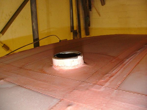

      While on the subject of tank filler necks, the fabric should be sealed against the neck so as to prevent spilled fuel from getting inside the wings. A rotten rear spar will be the result.

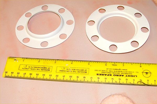

      Here's the tank reinforcing ring.
      Outside diameter is 4 and 3/16 approx
      Inside diameter is 2 and 5/16 approx to match filler neck diameter.
      Depth of recess is 3/8" approx
      Eight holes 1/2" diameter through which to bond fabric.
      The second photo shows the result. Note the fabric up the side of the filler neck to prevent fuel spillage ingress into the wing (I have longer filler necks than standard...see here for explanation).

            Paul - just to make sure, please see attached pic. That's what you mean, right?

              That's it!!! Rob, in his own inimatable style, has just posted a couple of excellent examples. Those little buggers are hard to come by but they are very necessary.
              Rob, if you see this, have you attempted to mfg any of these rings? I tried once and failed miseraibly!
              Good luck Mike. Worst case sceinero, call St Louis Metal Arts. I think they have an ad on Barnstormers.
