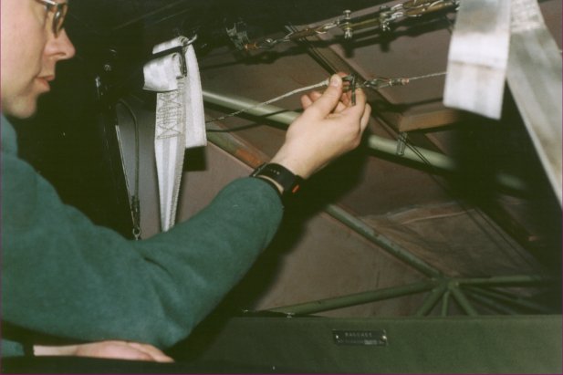

When I took 822 apart, I was very careful to label the control cables that connect behind and above the sling bench. The main lines connected without much problem (some straining and pulling), but the third cable (the one with the small link holding the end together) doesn't have enough slack, so I'm thinking the turnbuckle will have to be opened to do the job (I'll count threads before unscrewing the buckle).
What is that third cable for? - Mike
