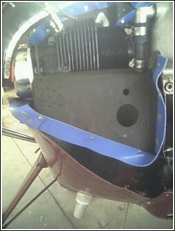

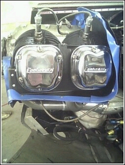

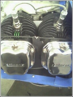

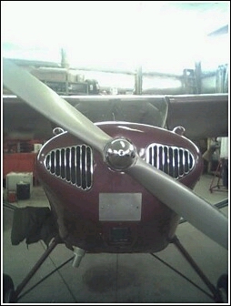

                    Yellow duck,
                    Here are some pictures of my engine baffleing...they really don't show too much but hopefully it helps a smidgen. The only ones I made from scratch were the side ones, the pressed front and back were the originals that I just reinforced in some areas and smoothed out the rough edges.
                    --Suzy

                      Suzy, looks good. Thanks. Really like the chrome grill and Valvue covers. Who did them for you ?

                      Still trying to work with one hand, not easy. One more week and the cast comes off, that will help and I can get going on this annual and sprucing up things a bit. Really like the chrome value covers and grill. Hell think the Duck would look good like that.

                        Hi Lee,
                        I bought the chromed valve covers from wag aero for $70 or so and the grills I bought on ebay and took them to a custom bike shop here to be plated. I took them in along with my steps and for the 4 parts it ran close to $200. If you decide to do your grills, make sure you find a plater that can plate aluminum...not everyone is capable. It also takes about 3-6 weeks to get them back.
