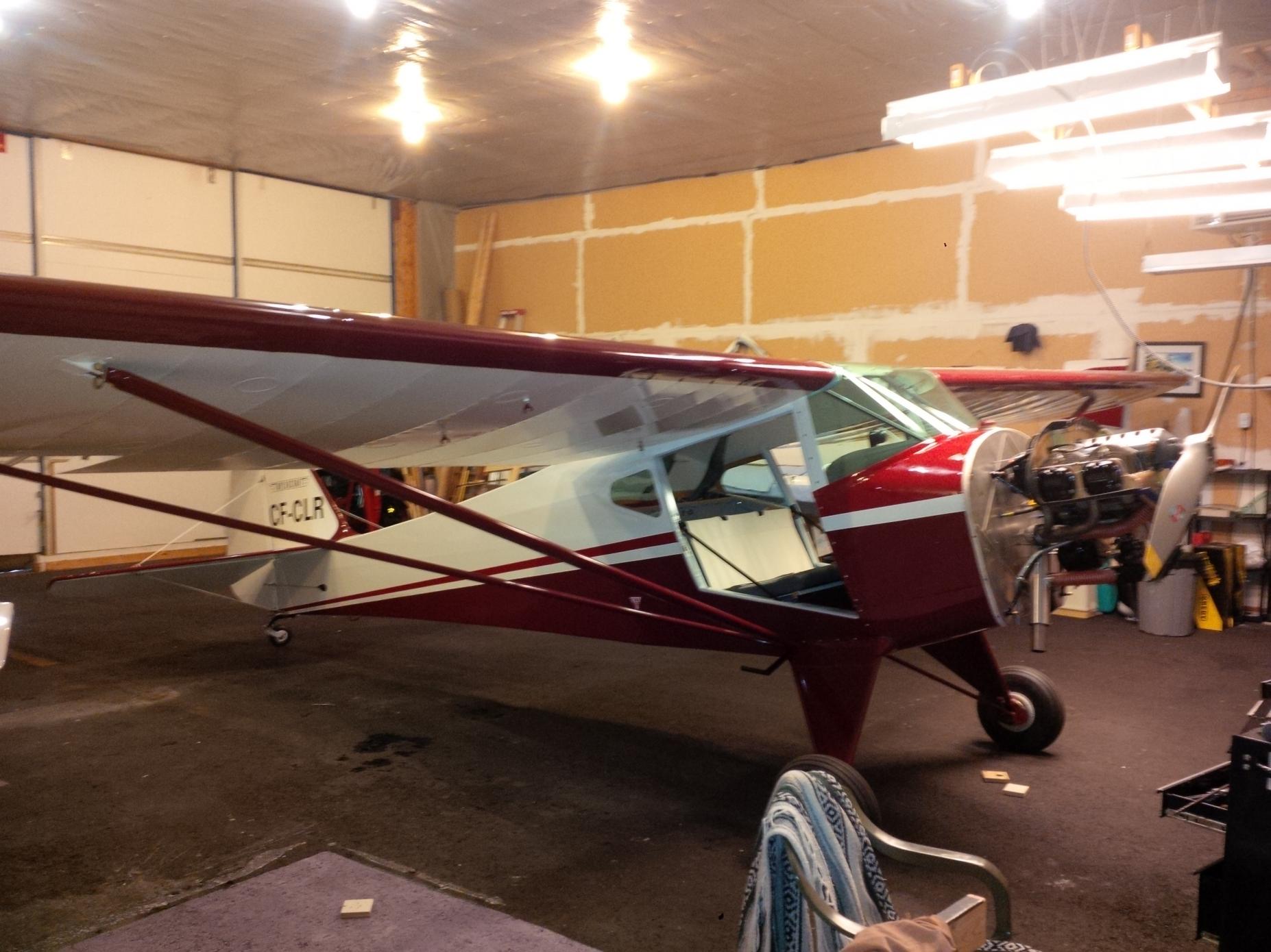

the mummy lives
  • the mummy lives
    First signs of life for 29 years
