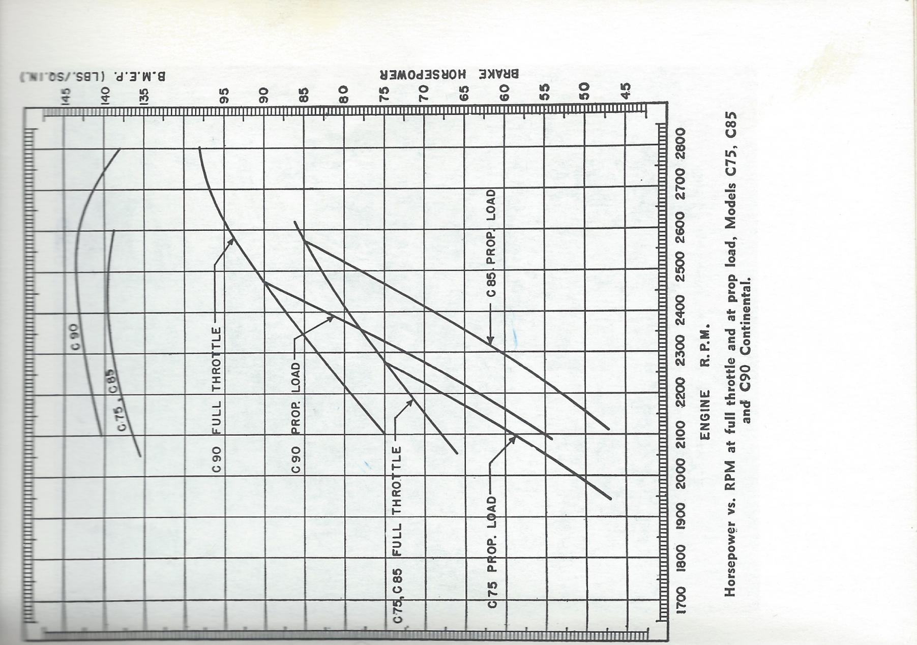

    Hello,
    Would anyone happen to have a C-85 operator's manual they would care to share a copy of please? Note, I'm specifically after the operators manual that has the chart plotting RPM vs HP, which is not in the overhaul manual.
    Thanks if you can share, Mark

    Here's some. To convert the torque to HP from that curve use this (http://spicerparts.com/calculators/h...que-calculator) or multiply torque x RPM/5252.
