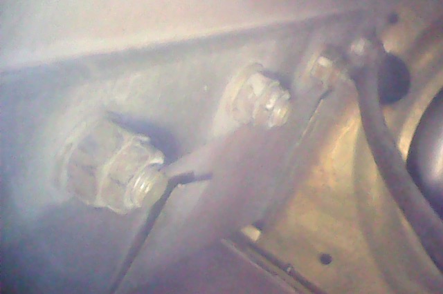

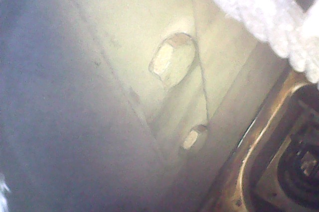

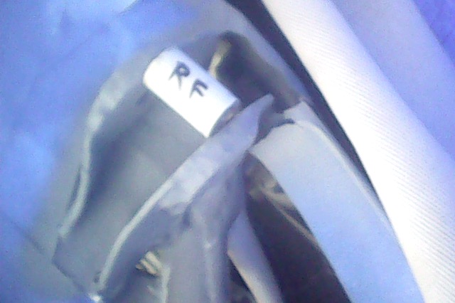

        What do you mean by "wing straps"? Got a photo?
          Re: AN5 torque value
          Uh, upon inspecting inside the wings with a borescope it looks like each "strap" (wing attachment fitting) is on each side of the front spar bolted through the spar and to each other with at least 5 or 6 bolts. So i referred to them as straps. My wings are not open and the slot for the pitot is small so my observation is limited. I'm not sure what my kids did with the camera at the moment.
            I can see someone scrapping another set of spars if they use the torquing method...
              I used an bolts with cotter pins, barely finger tight because there is nothing to prevent crushing of the attach fittings. They are only in shear and as long as they dont fall out, you are OK! One former member on here (DOT) tried to torque the bolts for the spar compression tubes, it wound up crushing the wood under the washers....Tim
                Ok, the kids have the camera so I get to use the $10 Malaysian borescope. Here are some pictures for entertainment value. Thanks for the heads up on torque. My fuselage wing mounts have a length of 5/16 I.D. tubing between the tabs. The wing spar fittings go on the outside of the fuselage wing mounts. To compress the spar would be pretty hard as you would need to bend the fuselage tabs and crush the metal tubing.
