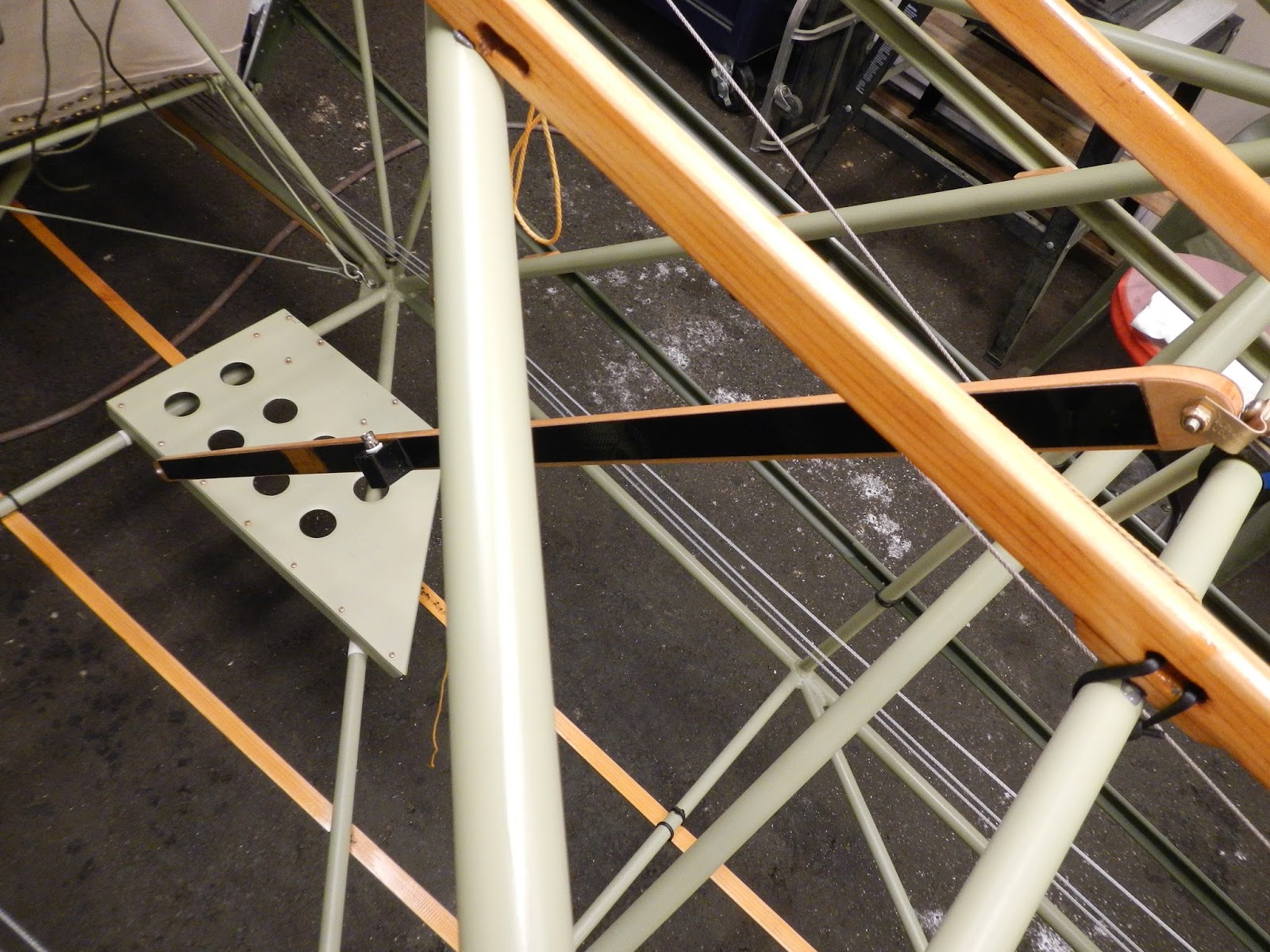

                Would you have a photo of where and how you mounted your antenna, Peter?

                  I mounted one like this glued onto a wooden slat mounted in the aft fuselage on a clip wing. IIRC I used an Adel clamp to and bottom.

                    Glad to hear it works! I installed one of these as well

                      Mike,
                      My installation is similar to Scott's, except I used zip ties to affix it to the wood.
