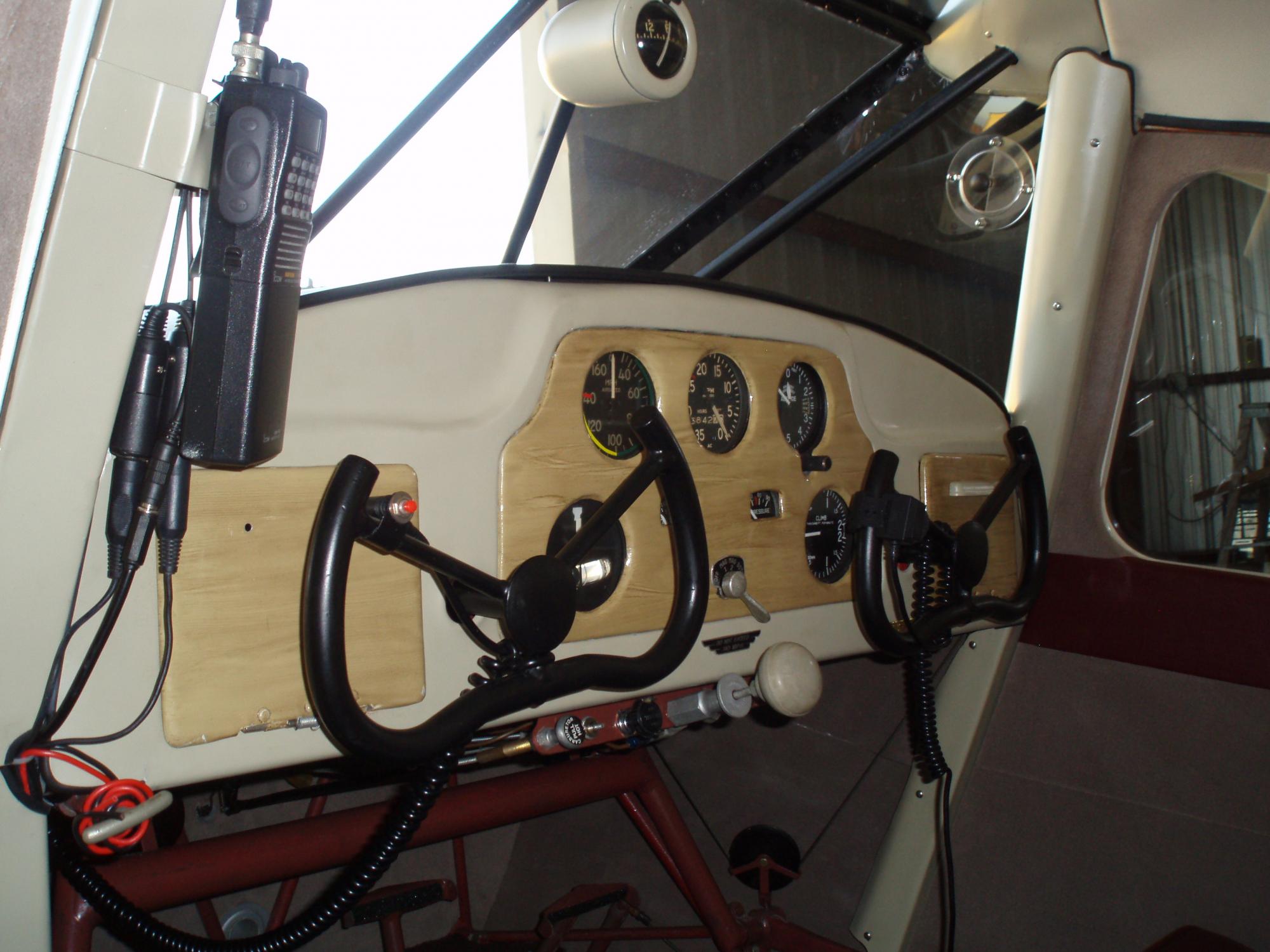

                  I used an iCom IC A22 and they are great radios. I even went so far as to buy a second in case I ever run into a rundown battery. I did mount an external antenna on top back by where the aileron cables cross. You will need to lace a coax cable from the external antenna to the place where you hang the radio. I made a belt clip bracket and hang mine on the A Pillar where it does not interfere with visibility and is easy to see and use. The output impedance from the hand held DOES NOT match regular headsets but an intercom will shift the impedance to get them matched (volume will be VERY low with the headset plugged directly into the radio). When you put the antenna in remember you will need a piece of metal between the stringers that will act as a ground plane.
                  I also have a battery box in my plane (on a pre war it is in front of the seat on the floor) and a 12V battery like is used in an electronics UPS or an emergency exit sign. Plenty of power to run a hand held and even the lights for a while. I just charge it on the kitchen counter but honestly I haven’t put it in the plane for over a year. An extra iCom battery does fine especially with the whole spare radio. You WILL want headsets and if you get one with Active Noise Reduction be prepared for some surprising sounds. First time I used mine it suppressed a LOT of the engine noise and suddenly I was hearing all kinds of funky pops, clicks and buzzes I never heard before. Most were normal “airplane noises” I was used to from flying a 2-22 glider but one buzz was really strange and was traced to a piece of baffle that vibrated at one RPM. Never heard it because of engine noise before the new headset.
