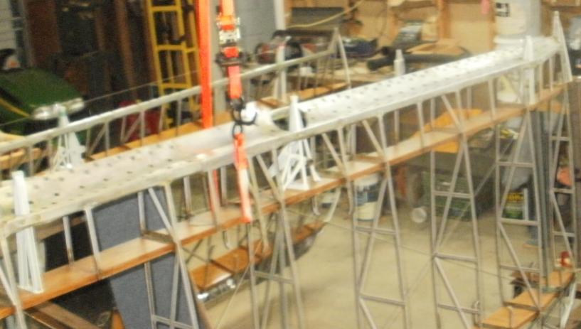

      I'm not certain without doing more research, but there may have been a design change in the aileron cove itself. I don't remember the pre war cove having the bead rolled in and the edges folded over and riveted. I think the older ones may have just had a flange with a broke edge. If that is the case that would be the difference between needing the braces and not needing them.
      Right you are. A closer look at the photo of the truss wing Mark posted above confirms the Cove panel update.

          See a pic of my wing attached (I hope).

            We need to figure out when (and if) a change in production happened (and why). Might not even be possible.
              Re: Trailing edge False Ribs
              Seems clear that 3Dreaming has it right. The change occurred with the change in aileron cove panel design, and it appears likely this coincided with the switch over to stamped ribs. The wing drawing was apparently only partially updated.
              The upper edge (cap) of the later coves is formed into a triangular cross-section and riveted. Much stronger, more rigid compared to the previous design with a simple 90+ degree flange. The stronger coves eliminated the need for the inter-rib support.
