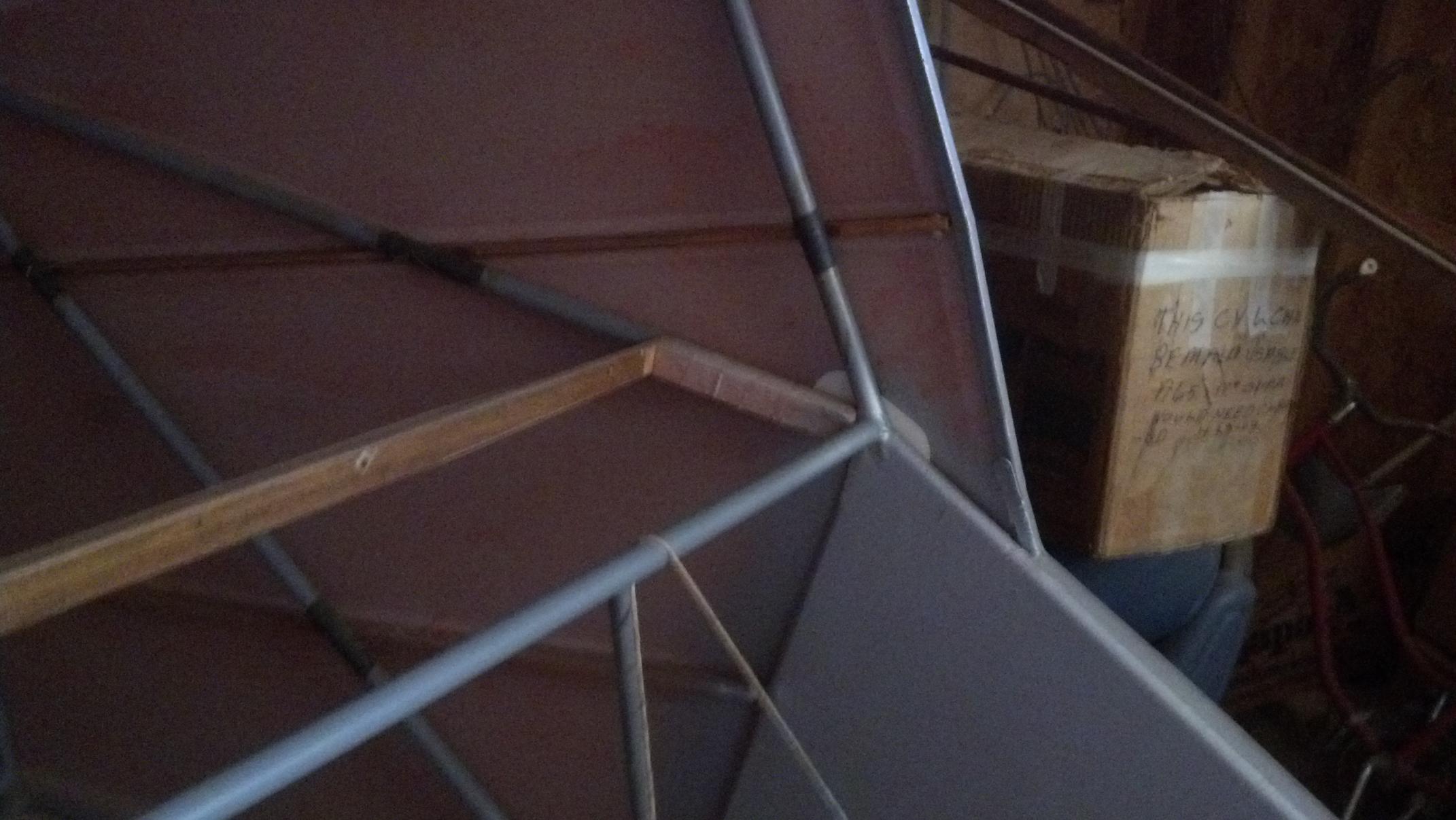

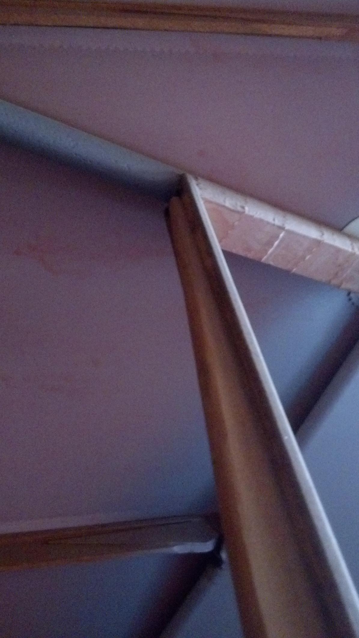

Re: location off rear baggage support
The reason you have no tabs already is because it is not supposed to have tabs. Along each side tube there is a 6.5" long 1" square piece of wood that has a half round groove cut in one side to fit around the tube. these blocks are wrapped with finishing tape and doped to hold them in place, like the wood pieces on many of the pre war airplanes. The rear cross bar attaches to the end of these pieces on both sides. Here a couple pictures. They are not great, but you will get the idea.
